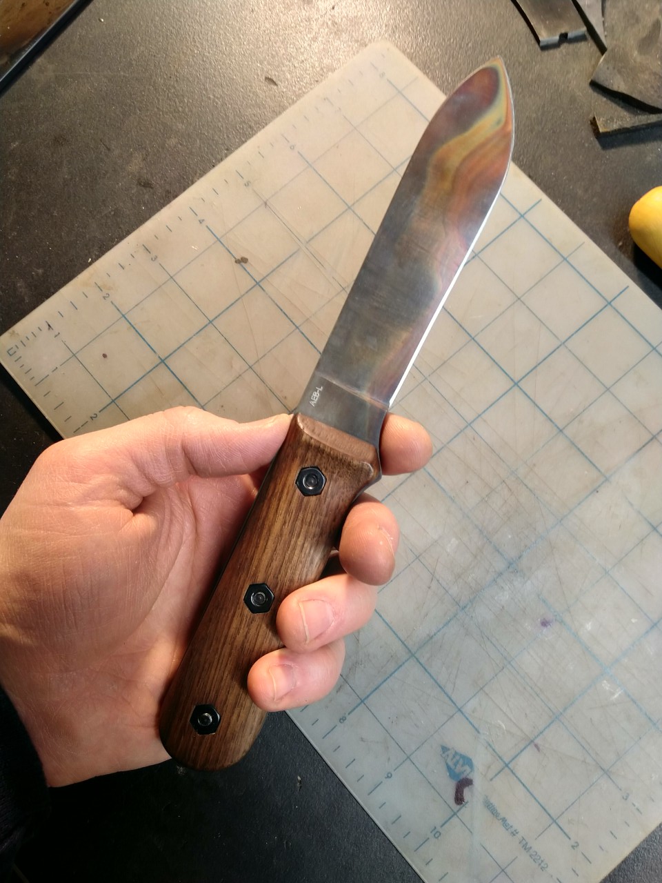

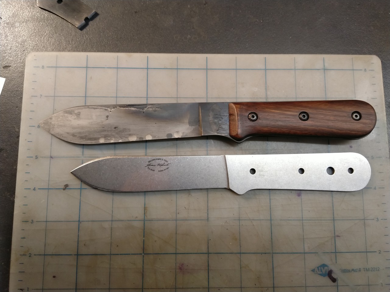

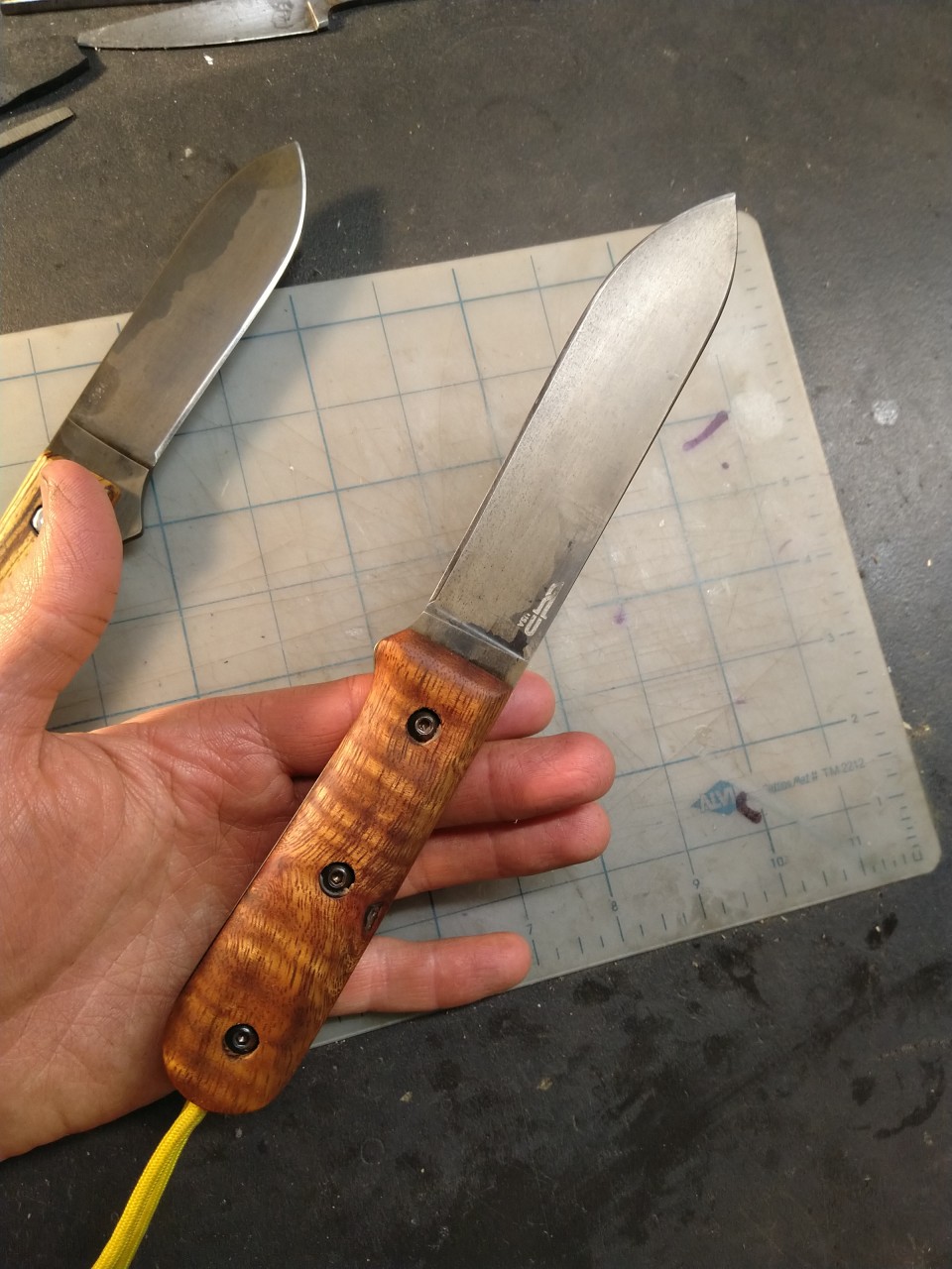

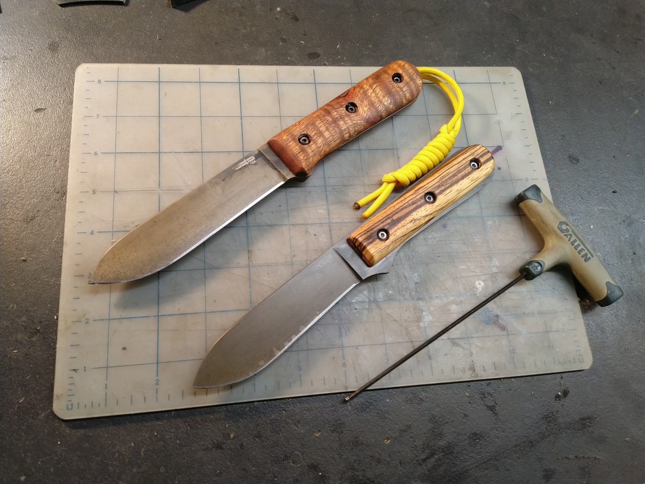

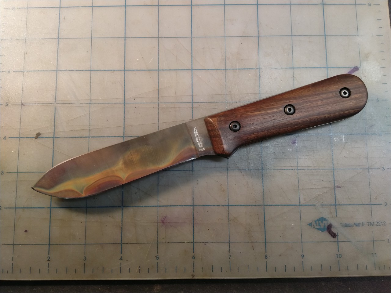

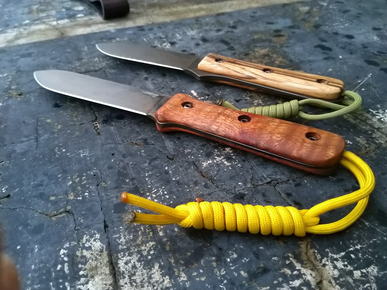

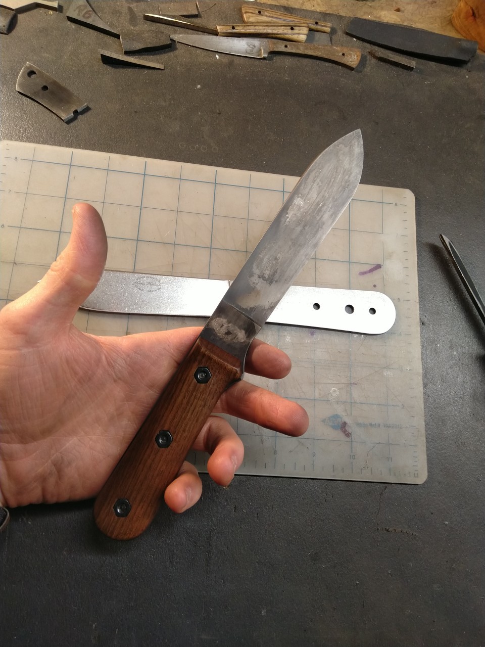

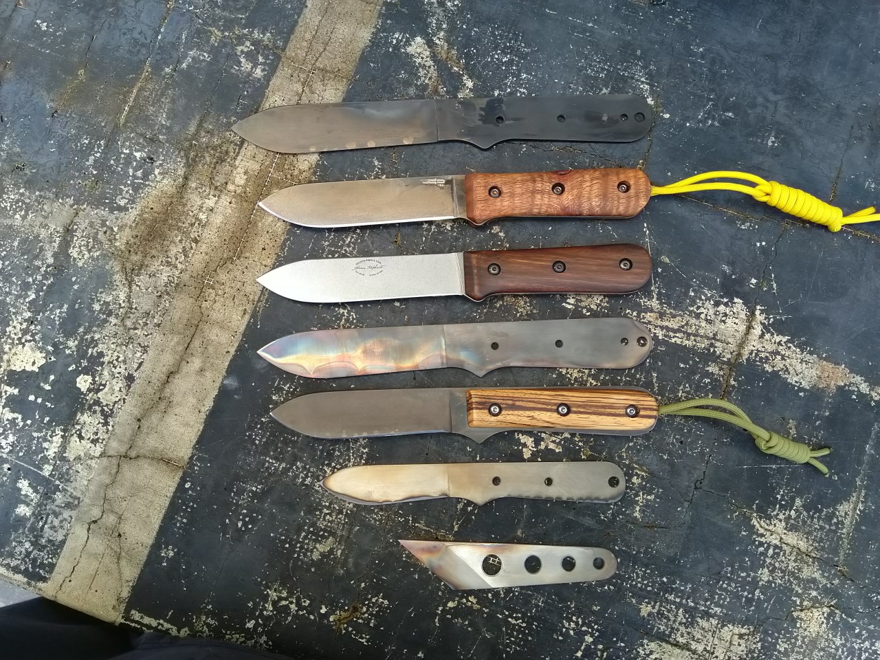

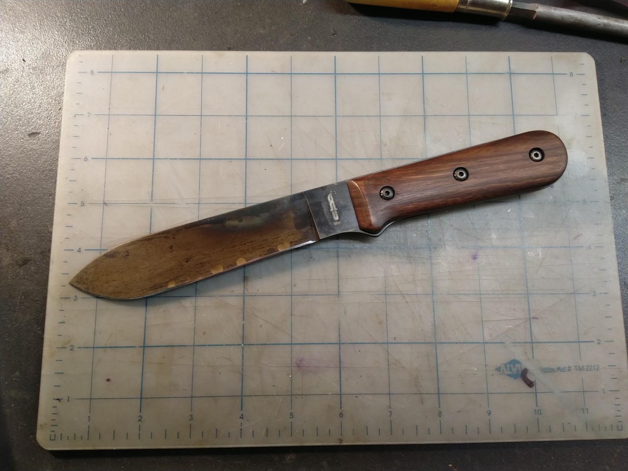

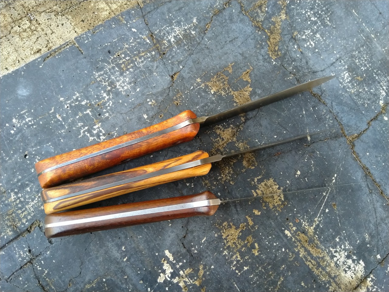

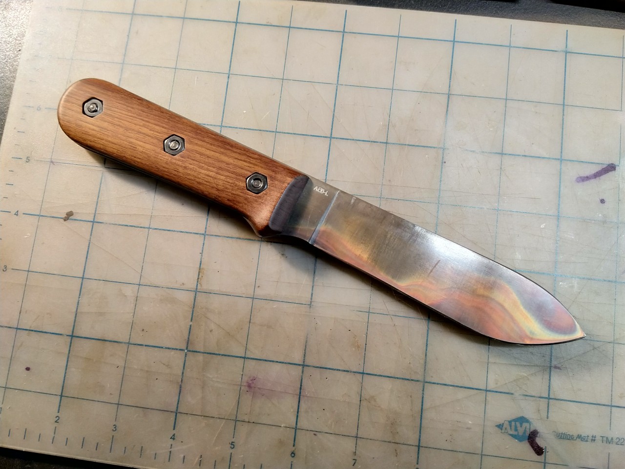

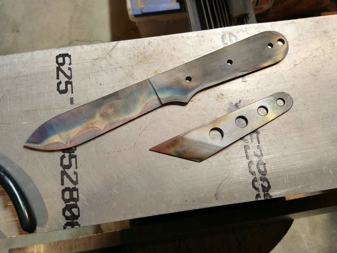

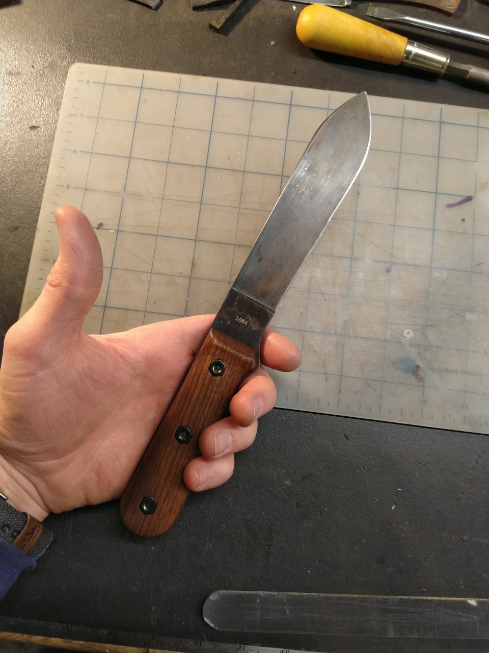

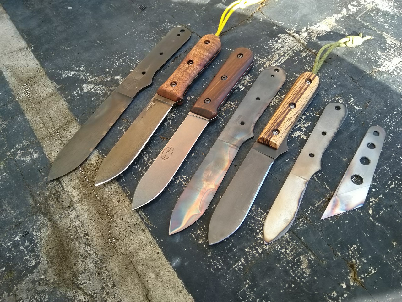

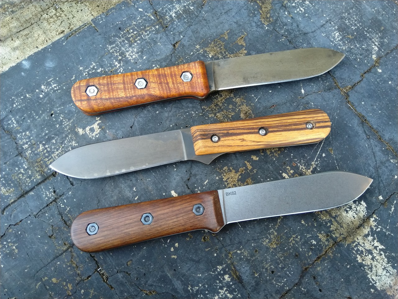

Some progress on the Kepharts. Decided to whip up some "oh I just have some koa kicking around" scales for the Auk5, and attempted some straight scales for the Auk4s in Zebra. The straight zebra scales were a miscalculation, as you can see. But it did give me a better sense for the handle width.
The factory Ka-Bar scales are really thin, and material that thin and contoured is very difficult to work with using my tools. CNC is the way to go if making bolt-on scales this thin. Pinned or bolted-onto the balde would be way easier, but I didn't want to kiss the tangs with abrasives. This pretty much confirms that I shouldn't be making scales for this blade pattern, and I'll happily wait for TKC and/or Ka-Bar to come out with accessories. I'll likely go back and thin my homemade scales some more (and refinish *again* ), but ran out of steam for the day.

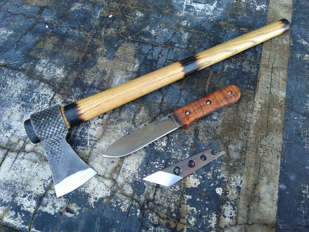

And a Nessmuk Trio with my rasp hawk from @damselflyforge:
