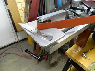

The middle picture is a30 on my horizontal grinder, horizontal makes a huge difference with finish when using belts
[/URL][/IMG]
These are timascus scales finished to a6 with my horizontal as well.
[/URL][/IMG]
I really need a horizontal grinder. I have gotten good finishes with the A45 and a30 but it seams a tad more tricky.
