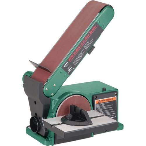

I have noticed that everyone here recommends 1" or 2" belt sanders.
There are many 4"X36" sanders out there, most with a bonus disk sander for very reasonable prices. What's wrong with these?
I noticed on a woodworking forum that a plane blade maker who uses mostly hi-speed steel (M-2 and M-4) uses one of these for final shaping as well as sharpening all of his tools including plane blades, knives, chisels, etc. He simply tapped a couple of holes in the sander on each side of the belt and fitted a simple adjustable tool holder.
He uses the disk sander for final shaping of handles, etc.
Except for recurve knives, I don't understand the need for narrow sanding belts.
However, there must be some reason people want to use those narrow belts. By the way, metal working belts of ceramic and silicon carbide are readily available in the 4X36 size at discount prices through several sources including Supergrit.
Thanks for any comments. I am trying to decide between a nice 1X42 like the Lee Valley or Kalamazoo or going with a decent 4X36.
The 4x36 doesn't let you work close to the belt like the 1" & 2" belt sanders do. The question comes up about once a month in the makers forums as well. I asked it at one point too. :D
The belts are also comparatively more expensive, have less selection, and a couple other things.
I'm not sure what you mean by that. The way I see it, it's almost like a sharpening stone that moves. You get flat area to work with just like you do on a whetstone.

Look at the front of the KMG style grinder, where you would be working, at how much clearance there is around the belt.
4593d1213630562-ot-my-first-metal-project-home-built-kmg-style-sander-cropped-dsc_0002.jpg
Then look at the same area on a 4x36. You can see that you can't even work at the edge of the belt. On mine, I ground out a divot on each side of the platen, so I could work the edge of the belt up to the plunge line. With a normal machine, you can't really make any cuts deeper than the thickness of the belt.
You can see that you are much more limited when working with a sander designed for woodworking. As far as sharpening, it has worked fine, though it is pretty obvious when you mess up. :D
That being said, I have built knives with just a 4x36, so it can be done, it is just that there are better tools for the job. I think this was #3 or #4, the others were a scandi grind.
