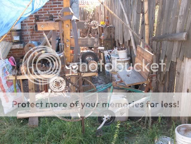

If you're thinking about making a grinder, then I have just the design to follow. I found a picture of a homemade 2X72 grinder that fascinates me, and think it is what you're looking for. A peddle-powered belt grinder. If you use the gears from a racer you can go as fast or as slow as you want.
I believe this gem was in Mexico where they have a saying "Queder es poder". A literal translation is "To want to is to be able to", or "If you want something bad enough you'll find a way to make it happen".
