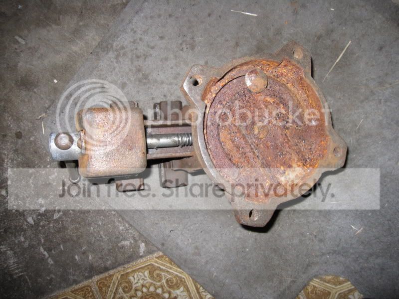

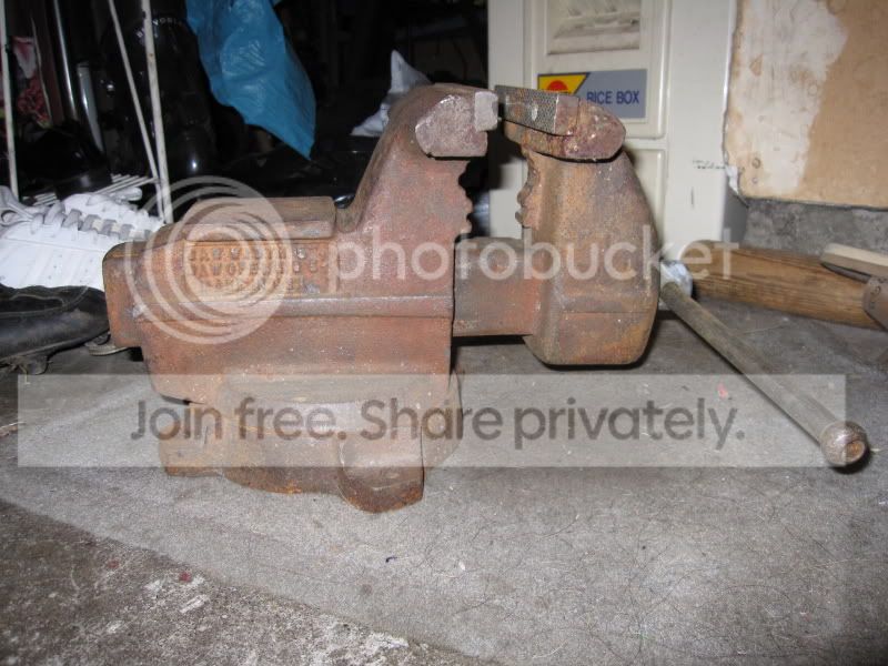

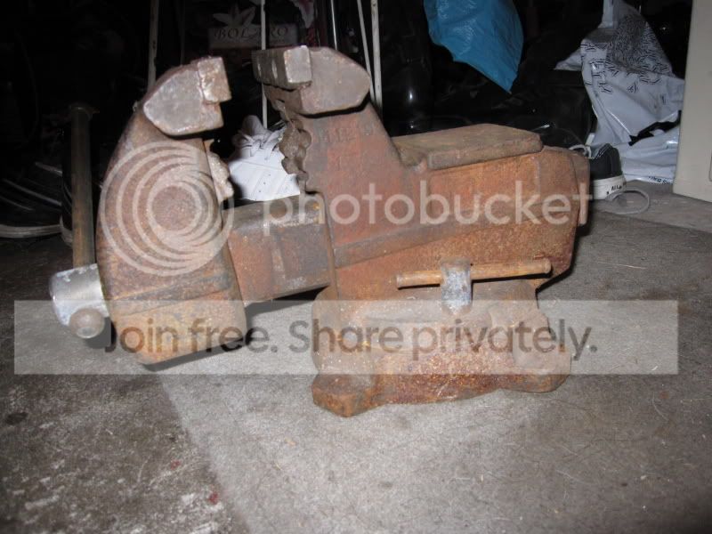

Since making my first knife at a friend's shop, I've ordered a Delta 1"x42" belt sander/grinder, 19 belts, and some A2 steel. I still need to pick up things like files and better light fixtures. My garage has a bunch of old tools and I've had this old bench vise as long as I could remember. Over the last few years, I've only used it a few times, other then that, it's been rusting away.
I plan on fully disassembling it and cleaning it up. Anybody have any tips to help remove some of the rust, like soaking it in something? After I get most the rust off, I was planning on hitting it with some sandpaper to smooth it out and make it look presentable.
Here are some pictures.
Also can anybody identity what brand this is? It's weighs a ton and the jaw action is still very smooth after all these years. The second picture shows a date stamp I think, "11 12 19", and there seems to be something right below it but all I can make out is a "1".

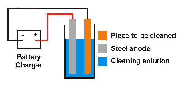

Wow, great method. I have a giant vise I cant use because of rust at threads at the backyard. I might use that method for it. You have to be very careful about that hydrogen gas though.
I have used the electrolysis method for a couple years now, and have used it on dozens of things.
It is hands down the best way to remove rust from a ferrous material that you don't want to damage with abrasives.
I've used it on everything from an old framers square to the parts of an old drill press. I have a 36" Starrett straight edge that had some surface rust on it, and I obviously didn't want to use coarse abrasives.... cuz it wouldn't be straight anymore ;) This process worked like magic :)
I use a piece of 4X4 ss angle for the anode.
You can use any conductive piece of material as an anode. I've seen set-ups where the user had taken short pieces of rebar, put them vertically around the perimeter of the tank, and then used chain to connect them all.
The reason I prefer stainless, is because I can take it out, scotchbrite all the nasty gunk off, and use it again. If you use a simple black iron/mild steel like rebar, it will get ruined after a few uses.
It's best to use a wide piece of material. A thin anode with a broad surface area is best. I left some numbers out on my post above... the stainless angle I use is 4" X 4" X 0.060" It's thin, but has a LOT of surface area for the crud to be deposited onto.
I've been meaning to do a tutorial on here about this process, because it's so useful.... just haven't had/made the time.
Make sure your tank is a non-conductive material!!! Mine is just a 20 gallon plastic tote from the hardware store.
The "cleaning solution" is simple!!! Water and baking soda.
You can dip the negative (black) lead into the tank, just don't touch the anode to your part once you have current running.
I forgot to mention, I've used this process on two Wilton vises that needed some TLC, and it worked perfectly.
I've also used this process on an old post vise. I ran it through something like 7 cycles (80min each). It was so clean you could see all the scarfed and forge welded joints in it!!!
Remember, the part will look like hell when you first take it out of the tank!!! But a little scrubbing with grey or red scotchbrite, and it will be all spiffy. :D
