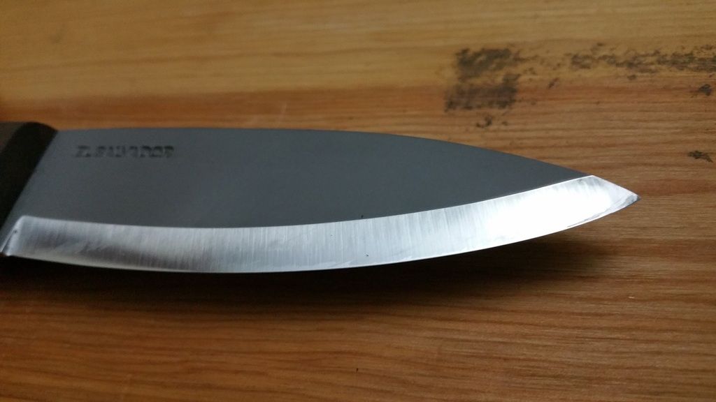

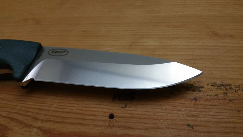

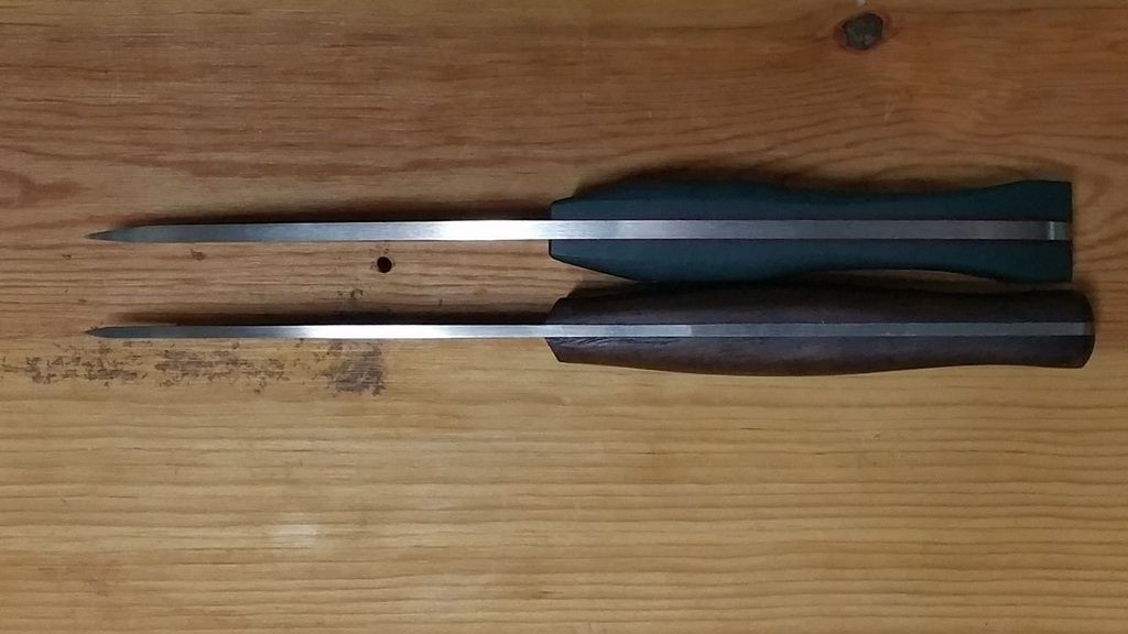

The Bushlore has a slightly larger handle and a slightly smaller blade.
It also has more of a spearpoint profile and more belly. The tip is excellent for drilling into wood. The Benchmade takes much more effort to drill out a pilot hole or divot.

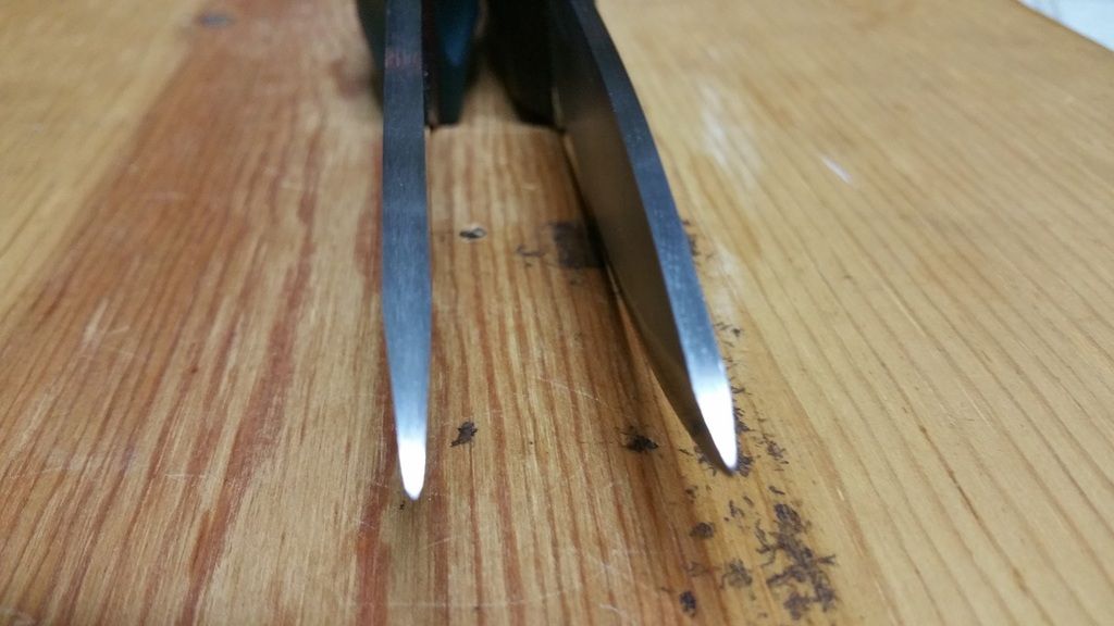

The Benchmade has a thicker spine that tapers less aggressively to the tip. This is either a pro or con depending what you plan on doing with the knife. If you are doing heavy duty stabbing duties, the Benchmade will obviously hold up a lot better. But I have had no issues drilling or light stabbing when working with wood using the Condor. At first I was a bit worried that the tip might roll or break when gouging or stabbing into wood, but it has held up fine.
The Benchmade has a high saber grind and the Condor has a scandi which I think is actually more like a very subtle convex grind.

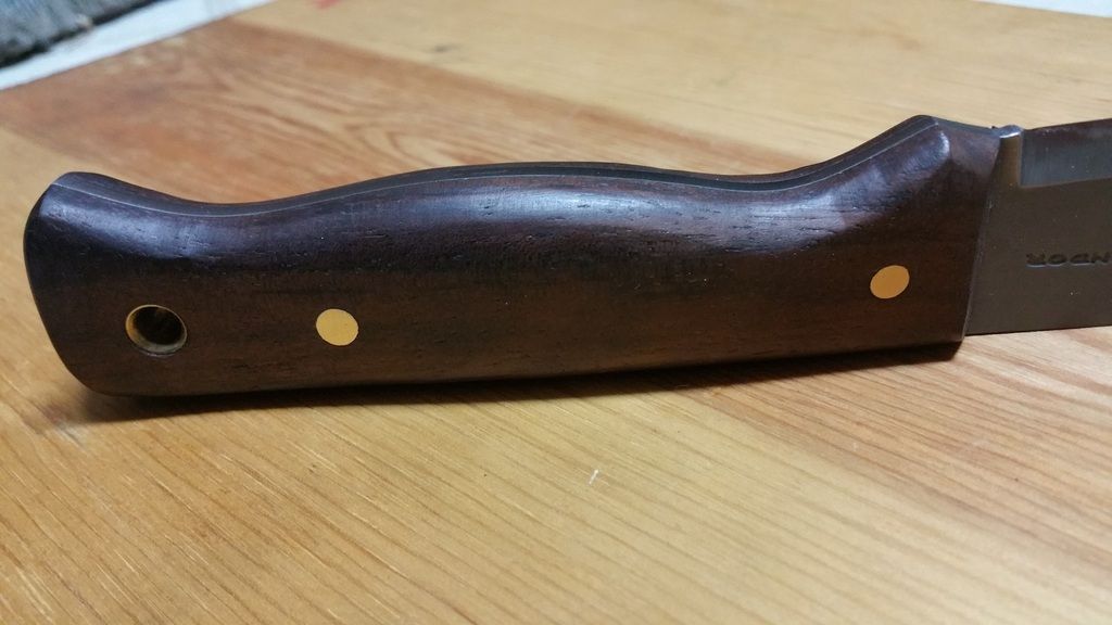

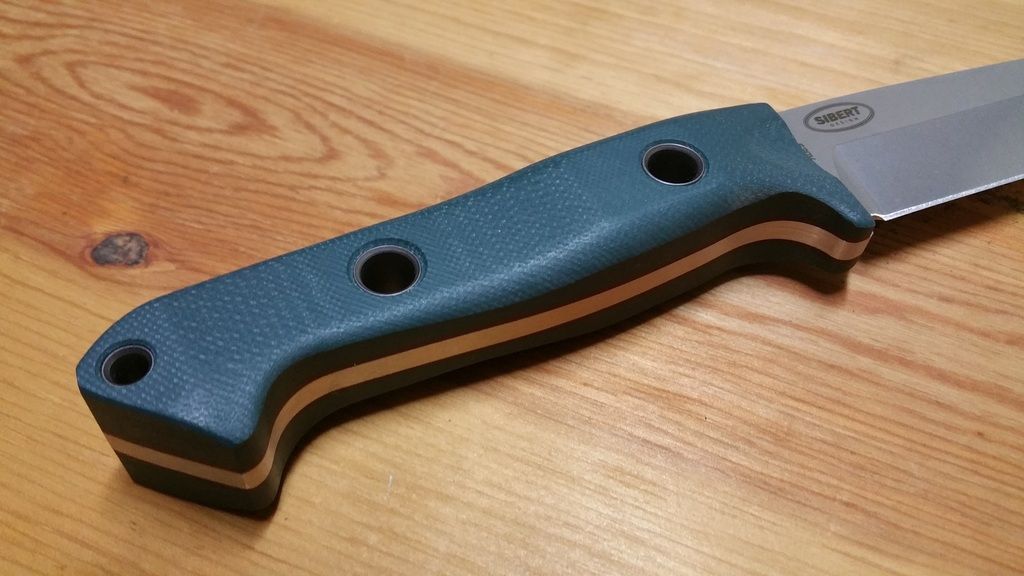

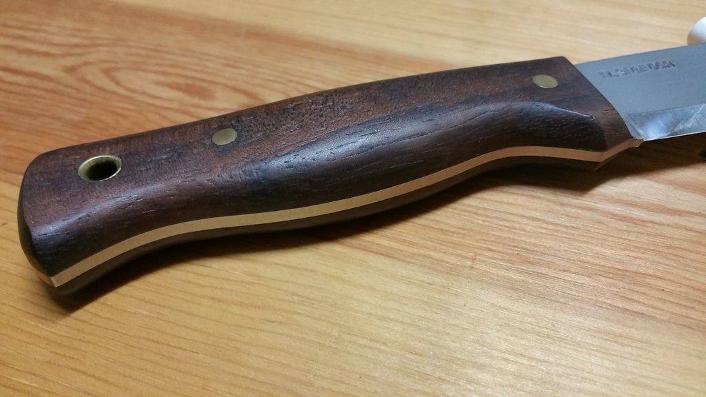

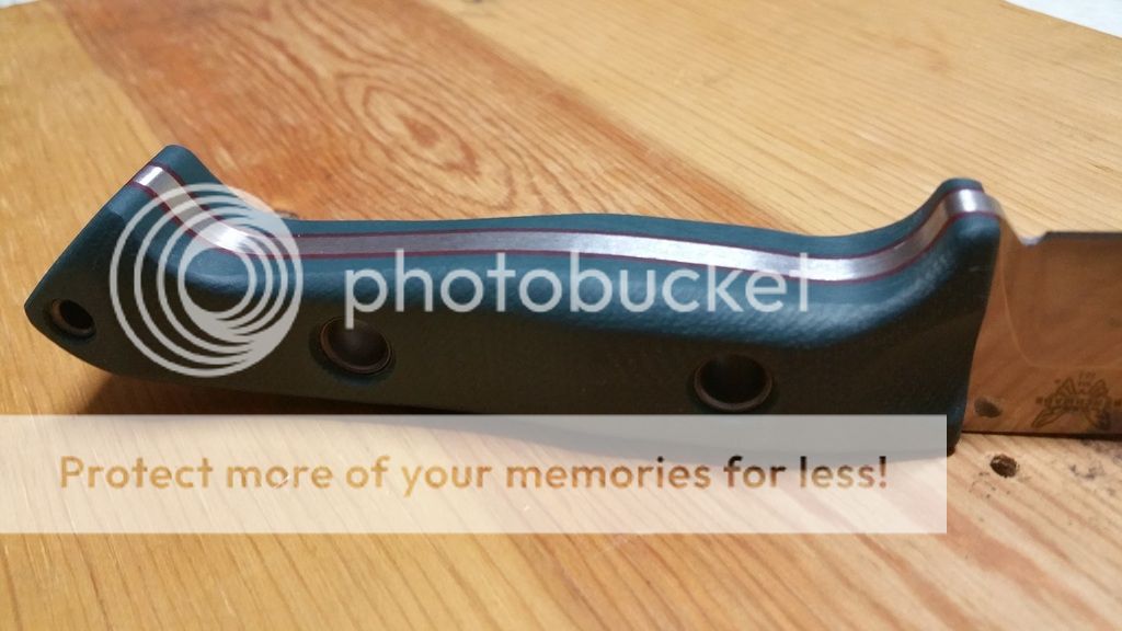

As far as handle and ergonomics, this is a very subjective area as it's not one size fits all. Depending on your preferences and hand size, your conclusions will vary. But I found that for me, I prefer the feel of the handle profile on the condor. It is less thick and the grip has a profile which conforms to my hand in a firm but subtle manner, even after hard use. The Benchmade starts out feeling fine, but after extended use, hot spots and cramping ensues, especially under aggressive carving. The wood on the Condor also feels more pleasing in the hand than the G10 handles on the Benchmade. The Condor was much easier to use when performing fine detailed work and tasks, just due to the more neutral handle feel. The Benchmade handles and heft makes it feel like a brute that you have to push around and for me, the handles get in thew way rather than assist when it comes to detailed work and finesse. The Benchmade is a knife that lends itself to more brute force types of tasks.
The handles are a lot wider on the Benchmade. For me, this also created lateral hot spots during extended use whereas the Condor produces none. The handles on the Condor have a more rounded feel in general where the edges of the scales meet the hands. After extended use, the edges of the scales on the Benchmade become more noticeable and seem to press into my hands rather than conform to them in a natural way. Again, this is just my impression and not everyone has the same hands. I just found that the scales on the Benchmade created too many pressure points over time and under heavy use. In short, they put a hurting on my hands, especially at the butt where the groove in the handle tapers downward.

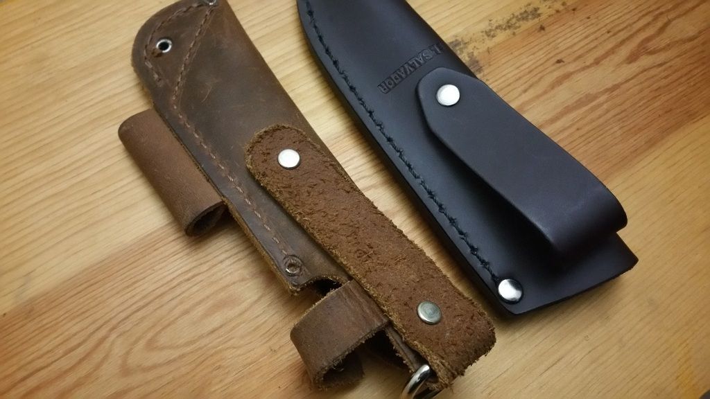

The one area in which I can say the Benchmade just totally fails is in regards to the sheath. When you consider the cost of the Knife, you would think they would provide a functional sheath of high quality. The Condor cost me a mere $35 on Amazon and came with a sheath that would probably run you twice the cost of the knife if purchased from a custom leather shop. It is solid and of very high quality in both feel and appearance. The Benchmade started to go sour on me quickly. The leather strips easily and warps and frays and leaves pieces all over the place. The knife starts moving around and cutting into the stitching. It also is not the most secure sheath I have used. The knife easily backs out of the plastic insert even with the buckle locked into place. Whoever designed this sheath needs to find a new job. Sorry to be so blunt but Benchmade can do much better than this. These are not $20 made in China Trinkets. This is a $180 knife. They dropped the ball in this area.

I have the Benchmade Bushcrafter, and when I first got it I didn't care for the handle's rather sharp edges and angles. After about 30 minutes on my belt grinder, the handle is now a well rounded and very comfortable version of its former self. All the hot spots are gone leaving a very functional knife with a good blade and good steel. It is now one of my main users. Of course I modify most of my knives so this is not unusual for me, but if you are handy with a grinder or maybe a file, the knife can be improved very easily. Now if you think that shouldn't be necessary with a 180 dollar knife, well, you gotta work with what you get, or maybe just don't get it.
