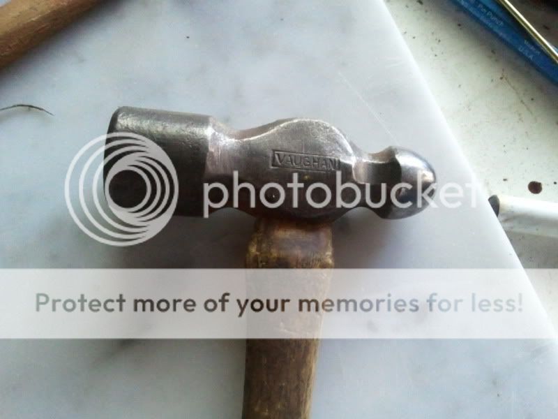

I just use an 8 ounce Vaughan I got from the flea market, but it has a long flat face that I am thinking about cutting down and reshaping to a half round. Yes, polishing the ball face is very important.
Here is mine and you can see where I am hinking of cutting it down to reduce the weight by and ounce or maybe two
-Xander
You should be happy with the Vaughn hammers. I have one I have used hard for almost 20 years.
