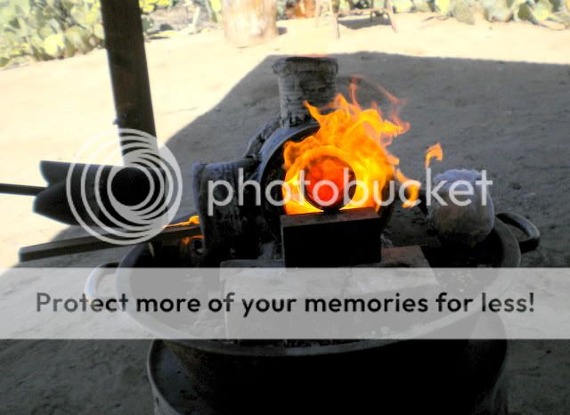

Tennessee: Please, for the love of all that's red hot, do no attempt to use that forge while it's sitting on a piece of wood. If I could make a suggestion, get a cinder block and use some metal cloth to attach it to the top of the block. The biggest problem with the 1BF is that it is light and moves around easily.
No for sure. I've got it on a granite table and wrapped in brick on all sides, top and bottom included. Never thought about posting the pic on a piece of wood. No wood near it now. Actually out doors to top it off. Good reminder though, thanks
