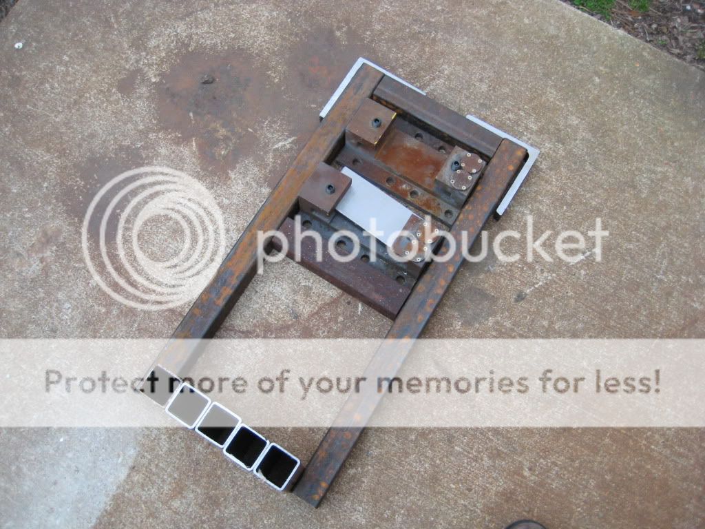

Hey everybody!
i am building a hydraulic press with a 20 ton air-over hydraulic bottle jack. i am making the press so that it can have interchangeable dies. I was planning on starting out with two sets, a "flat" set and a drawing set. The flat set till be just that, flat rectangular stock with the edged broken. Then a drawing set where the edges will have a significant radius to them.
My main use for the press will be breaking down stock and making damascus, and need advise with the dies. are those okay? should i make different ones? are the "flat" dies unnecessary?
What material should i make the dies from? I have some 1018 stock, but was i think i can get some 4130. Help me please
thanks!
~Chris

Whatever ever design of dies you decide to use, don't waste your money on anything other than A36 hot roll. Because of the intensity, and duration of exposure to heat involved with a press, no matter what steel you use, it will deform over time. I wasted a bunch of time and money trying D2, M2, and a couple of other materials for dies.....they all lasted about as long as pieces of A36. All I do now is use the pieces of A36 that are dimensionally what I need, and then tack weld them in a couple of places to the die plates.....whenever they deform beyond use, I grind off the tack welds, and replace them with new pieces of A36.

I tried it (H13) and its no better than anything else. It was frustrating to me before I realized what was going on.....no matter what type of steel you use (unless it's some very exotic/costly alloy that's made for this type of specific application) the exposure to the high temps, pressure, and long duration of a forging press application is simply going to "temper out" the material, and it will deform. Some of the material will last a BIT longer than others, but from what I've experienced its not nearly enough of a difference to justify the expense of something like H13 or D2.
Even though I generally have to replace my flat dies (the most used in my press) about every 2-3 months, its still far more economical to use A36. I never tried more than one set of dies made from the other materials, simply because I couldn't afford to. There might be something out there that will hold up to long term use as forging press dies...but I haven't found it, and don't know what it could be. (I doubt I could afford it, even if I did find it.) :)

this info is GREAT!! i am going to try and get some H-13 steel from aldo, and then i can get started. i am painting my motorcycle right now, so i am kinda busy, but then i am going to focus on this. I was looking to spend about $150 on a large air compressor, so hopefully i can get something bigger than 8 gallons.
here is the press as i have laid it out so far. teh die holders are actually sitting sideways. (i pulled those out of a dumpster)

As far as dies go, I am 100% with Ed on this... In this type of application, mild steel always works just as well as anything for me. Something else to consider, is the ease of working the material. You most likely will want to change the dies around once you get situated with a press, and mild steel is a lot easier to work with than anything more exotic.
Either way, best of luck Chris! :)
In the world of dies, I have to agree with Mr. Caffery. Keep them cheap. Simple A36 or other mild steel (1018) will make dies that will work fine. My first set of dies for this little press came from some big A2 blocks, which I found at the scrap yard. After a lot of use, they have deformed some, and have needed a little dressing. The mild steel dies I have made have held up about as well, and are a lot easier to work with when dressing them or making a new set, etc. If you can get tool steels at a great price, fine go that route, but otherwise I don't see the need in sinking that much money into them when mild will do just fine.
