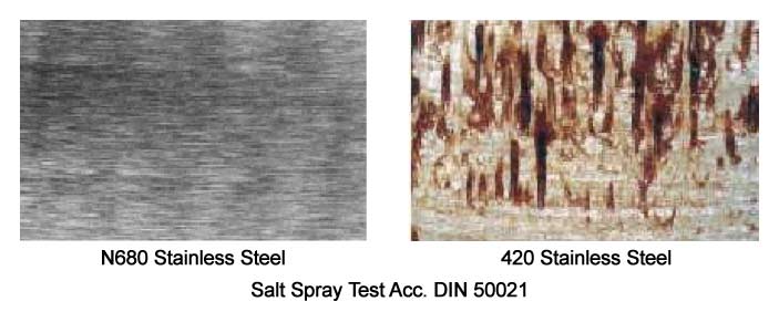

The nitrogen stainless steels far out class any standard stainless steels.
Here are photos of salt spray tests:
H1 has been made famous by Spyderco. It is a precipitation hardening stainless steel. We've unsuccessfully tried to buy sheet stock for years.
N680 is a cast nitrogen stainless steel. It is used by Benchmade for a folder and fixed blade. Heat treating is straight forward. Cryo is required to get maximum hardness. N680 is inexpensive and takes a toothy edge.

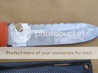

My actual dive knife is a Victorinox serrated paring knife with a kydex sheath I made. Dive knives get lost or misplaced, so the Victorinox is a good option.

A 440C knife will stay like new with some minor maintenance. If they want no maintenance then its titanium, but that will hold an edge like crap. From what I researched since originally posting this is what I came up with for the best dive knife steels:
440C -Best price combined with good corrosion resistance, fairly low maintenance.
S35VN/S30V -Hold an edge better than 440C, tougher to sharpen than 440C, and a lot more expensive. Good if you dont mind a bit of maintenance.
Titanium -requires virtually no maintenance (except to sharpen), but doesn't hold an edge too well and its a pain to work with. Also 6al4v won't work for this, will need a different test titanium.
N680 -Great corrosion resistance, low maintenance, but doesn't hold or take an edge as good. Edge retention comparable to 420 stainless.
Personally I would go with N680 or 440C.
