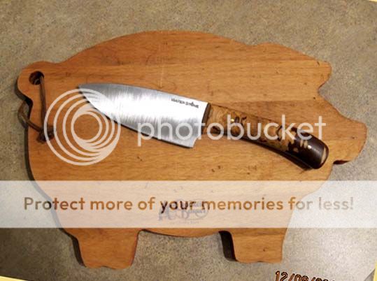

I have an Ontario knife made of 1095 that gets constantly used in the kitchen. I am not always the most diligent about cleaning promptly after using it. With this said, the patina is constantly changing. Once in a while, i'll leave a slice of lemon or tomato on it just for fun.
Yellow mustard works nicely in 01 steel. Smells kinda funny when you put on the mustard.
Ric
My wife took the first use(her gift) and said ..."OH!" and then let me use it also.
It almost falls thru the tomato under the weight of the blade...it's that good. Wonderful.
0.130" Aldo's 1084 double tempered and tested @ 62 HRC,
Bamboo handle finished to 600x sealed,waxed and brass hardware
Full flat Grind
5 1/4" length blade
1 7/8" height
0.011" behind the edge finished on 4K stone and stropped
10" overall.
http://www.bladeforums.com/forums/showthread.php/1238253-Aldo-s-1084-Kitchen-Knife-with-Bamboo-SOLD
My wife cut some more tomatoes, and said "WHYYYYY does this stink so much?"
Oh yeah, I forgot to tell her about that part.
So I tried to explain patina, and this morning I took care of it. I threw everything at it, including the kitchen sink. stuck it in a large glass with vinegar, salsa, mustard, small can of pineapples, applesauce, catsup...and let it stew for about two hours. I feel asleep, or I might have taken it out sooner.
My wife thinks it's pretty and now it doesn't stink any more. I like it also.
