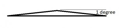

I guess I don’t understand why a beveled disk isn’t also flat. My understanding is that were you to put a square on the hub of the disk, the face of the disc would move away from the square at a 1° arc. Meaning, at the edge of the disc, it is 1° away from the square. But the face of that disc from the hub to the edge is flat. So if you only grind between the hub and the edge, isn’t it going to grind flat?
It is. It's a flat plane from center outward.
My take on the 1° bevel is so that you can grind your bevel on one half of the disk. If the blade is longer than half the disk, then the extra length doesn't hit the other side of the disk.
Then to grind the other side of the bevel, you switch sides of the grinder and put it in reverse, so the sparks don't get in your face.
Yes, but only on each radius line. Because we've got a disc, and each bevel point starts from the center, you have a cone.
Here's what we'd have if we cut the disc in half:
Yep.
I see what you are saying, about the hollow grinding effect too... Although I think if you moved the blade around at all while grinding it'd be pretty easy to mitigate.
I use both, but like the 1° bevel disc. It isn't "grabby" on a blade with a length over 5".
I think people are overthinking the arc thing. On a 2" wide blade with a 1° arc angle, the hollow is .005". And that is assuming you hold the knife at an exact center to edge orientation. If holding the knife at 45° to the edge-center line the hollow is less than 1/1000 of an inch.
