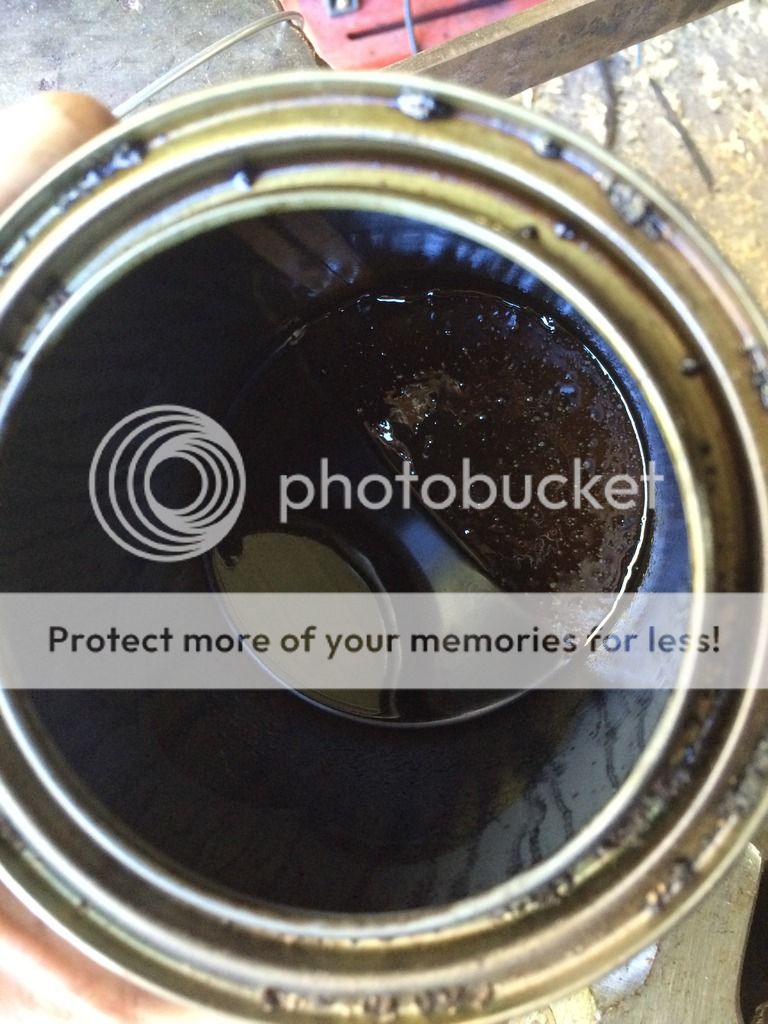

Yesterday I went about making some birch tar. After distilling a gallon of birch bark, this is how much I ended up with in a pint can

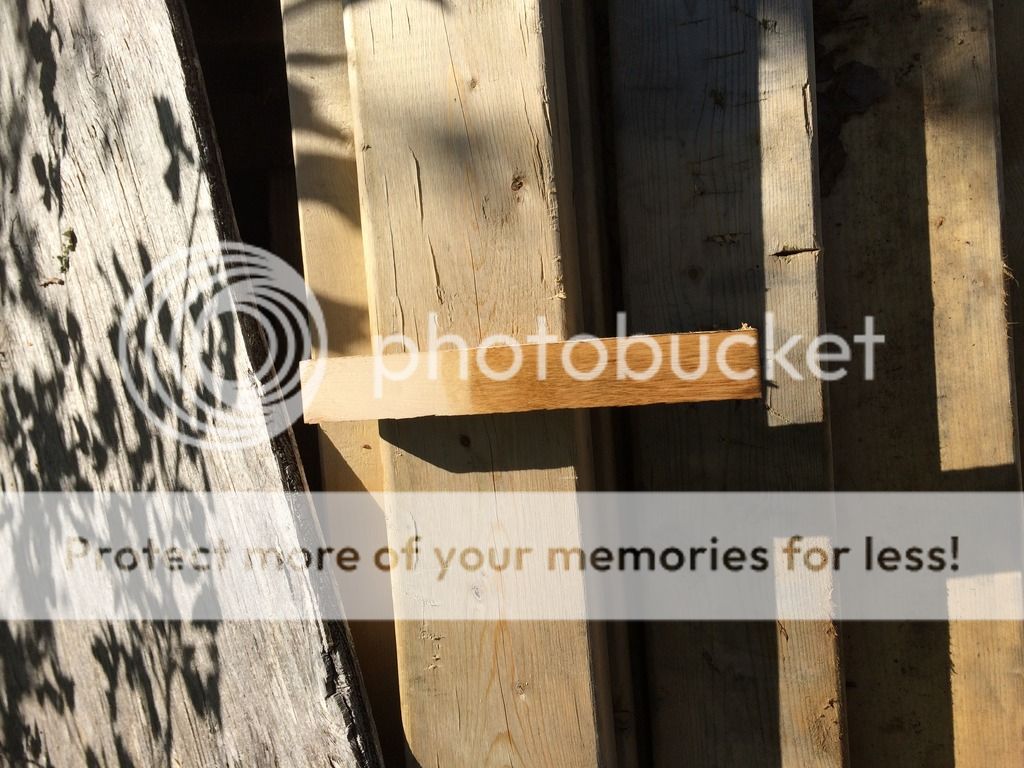

I used a piece of white birch as a test. Rubbed it in with my finger, and after about 20 minutes wiped the excess off with a cloth. Sanded to 120g before applying. The top of the piece is uncoated. After the first coat:
At this point it darkened the wood quite a bit. The colour is more significant on the end grain
Looks promising so far. It's supposed to darken further if left in the sun, like linseed. I'm going to apply more coats and see how it turns out

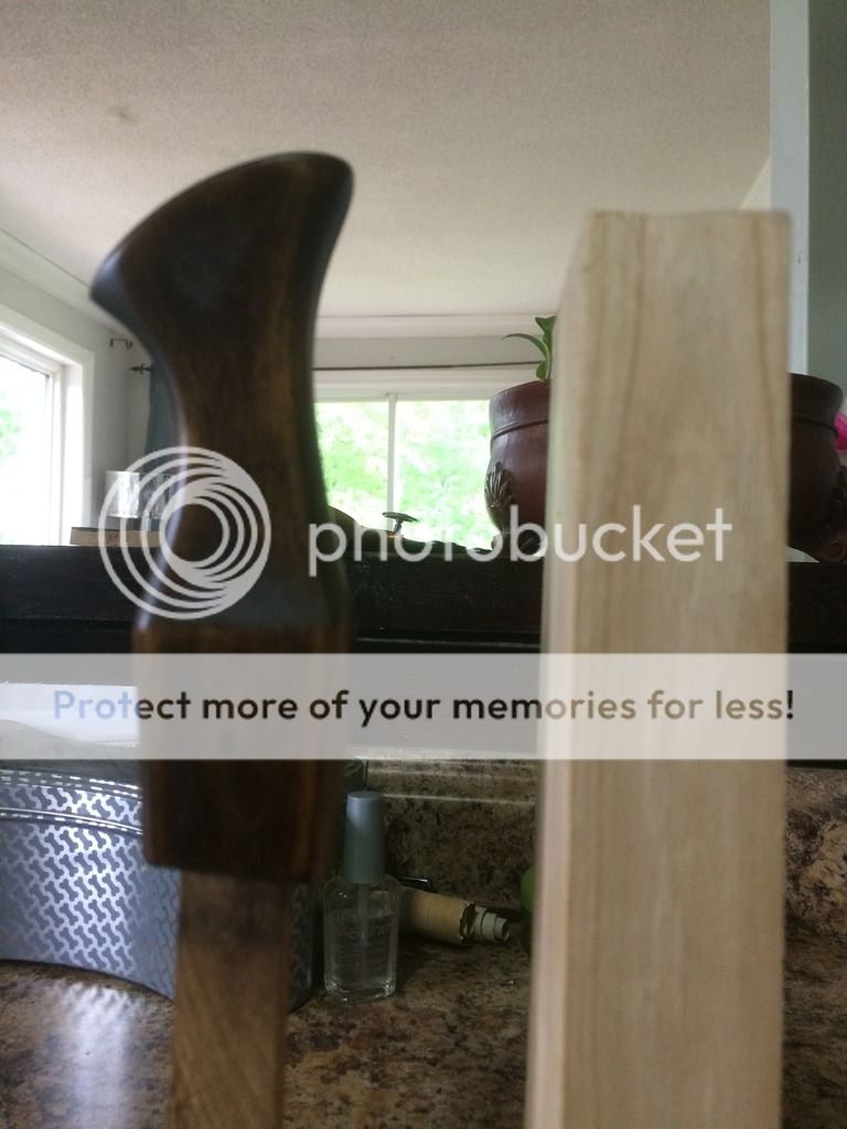

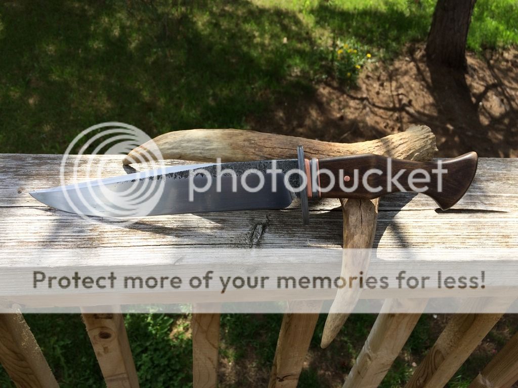

I used it to treat the wood for the San Mai Bowie I'm working on. On Monday I coated it and left it in the sun until it started to look dry and then coated it again. After doing this 4 times it didn't seem to be absorbing any more so I left it overnight and the next morning it seemed dry. Gave it a sanding with 1000g paper gave it another coat yesterday and left it in the sun. This morning I sanded with 1500g and coated again.
Here's a picture of where I am now. The wood is wild cherry. Block on the right is the original colour
