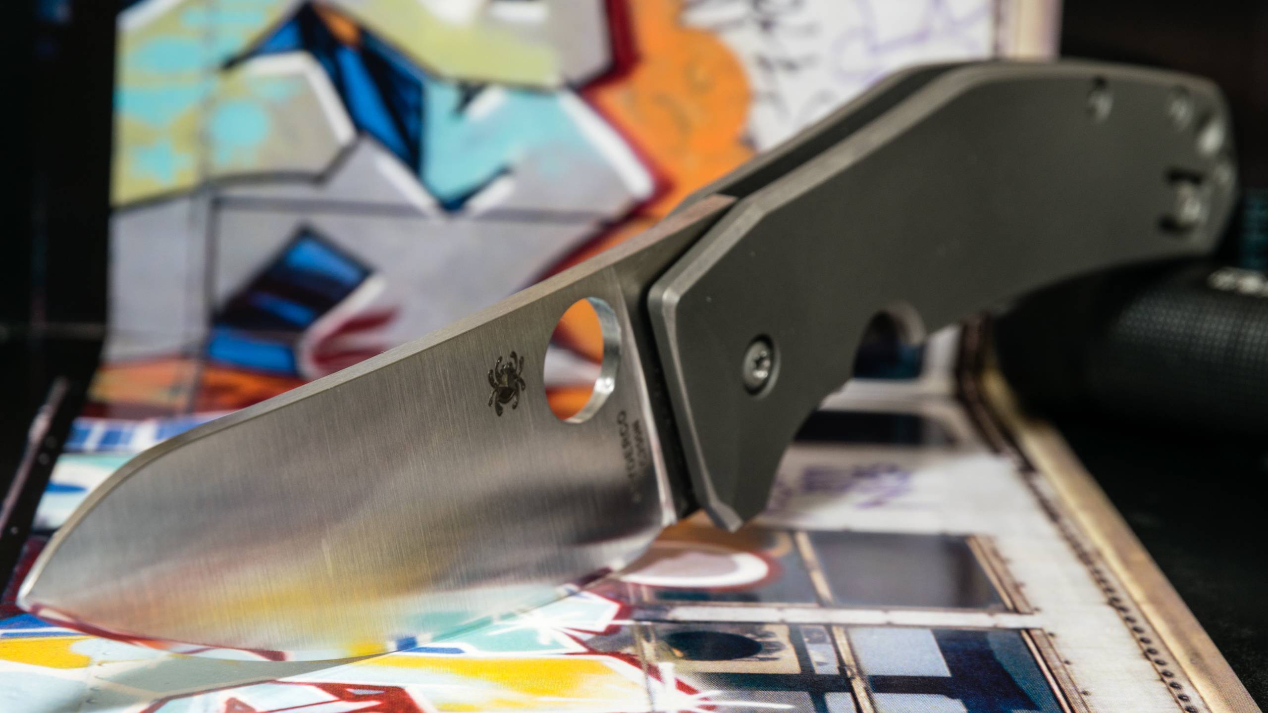

For example, my Spyderco Spydiechef has a ~10 degree per side edge bevel that was shaped to 1000 grit and then a 16 micron CBN on balsa convex microbevel was applied. You can see below that the 16 micron CBN on balsa finish produces a semi-mirrored edge bevel, despite how "coarse" 16 micron CBN emulsion is (in theory) as this convex microbevel has been touched up repeatedly over the last week or so:
