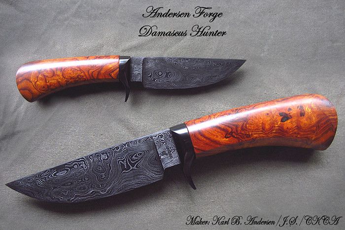

The black hot-bluing is something I will NEVER!! regret purchasing and offering on my knives.
I have been doing it for well over a decade and it has become part of my continuing offerings, plus look great on Damascus.
Anyone on this forum can do it.
My hot bluing video must be fairly enjoyed as it has had over 1600 views:
[video=youtube;AX6E_K_DMxg]http://www.youtube.com/watch?v=AX6E_K_DMxg&feature=plcp[/video]
A few example of what you can do:
Karl;
Beautiful knives, truely works of art. How resistant to rusting is the hot blue?
