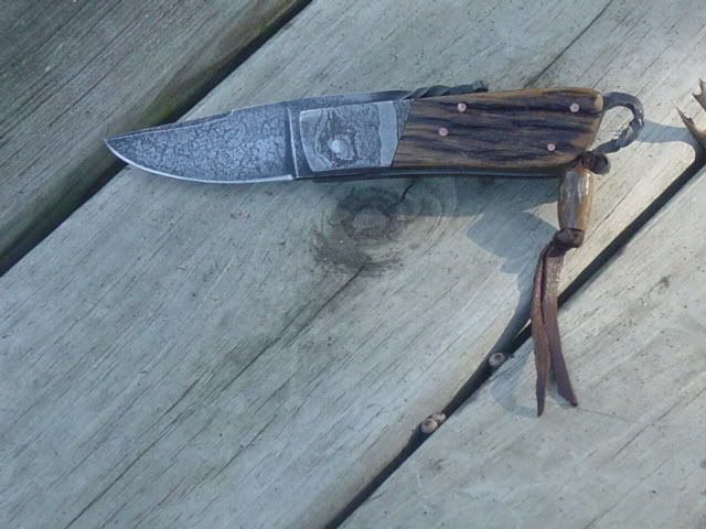

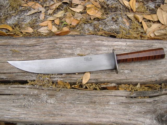

Go to my website, wickellerbe.com . Most that you see that are aged were done done by this method. You will see that some are aged more so than others. You can go from lightly aged, to relic condition. It is controled by time in. For the light age, I leave the blade in for about 3, to 5 minutes, clean up and see if it needs another treatment. If you want relic condition, about 10 minutes. The time in also depends on the steel. Low carb simple steel that might be used as hardware on the knife etches very quickly. Hi-carb 10xx steels are kind of mid range. 01 seems to be a tad slower. This one below went in for two complete treatments of about 4, to 5 minutes each bath. This can also be done with Laurel Mt. cold brown, instead of bleach, but takes a few days instead of a few minutes. Just cold blue it well and submerge in Clorox bleach, or any clorine bleach, but not the scented stuff. The bluing reacts with the clorine in the bleach. The scented stuff does not seem to be as fast.
Here's one that was done with the method you asked about: http://www.bladegallery.com/shopexd.asp?id=85394&photo=2&size=b I used it a bunch of times. I prefer using a wool dauber that is used to apply leather dye. I use the Cold Blue paste. I'll put a dab of the paste on something flat and then put the dauber in it. When I apply it to the blade I dab it on the whole blade. Let it dry and then put it in warm bleach for a few minutes. The warmer the bleach the faster it works so you need to really watch what is going on. Once the blade turns brown while its in the bleach you need to remove the blade and clean it off. You can either go back in the bleach a second time or stop after the first soak. After I'm done with the bleach I'll go over the whole blade with steel wool. If I want to remove more I'll go to 2000 grit paper. You want to make sure its rinsed off real good and put a coat of oil on it after your done and let it remain there for awhile.

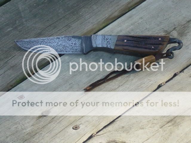

I don't really consider it bluing, but I antique many of my knives with the above described method. Here are a few shots...
