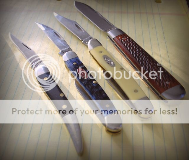

I grew up in PA, and did what you are doing -- I got a Queen, two Cases, and a Great Eastern, all from back home. The Queen took 2 days on the stone to get it thinned out enough that you could cut anything with it, but after that it was fine. Both Cases have blades that rub together. (Actually, one got fixed at the factory, but they left the scratches. The other one didn't even get that much.) The GEC, other than a fairly stiff backspring, is perfect (it ought to be, it cost almost as much as the other three put together)
Case is capable of excellent work, but at this point I wouldn't get one I couldn't look over first. It would be worth the extra bucks to get one at a brick-and-mortar store, if it meant you got to 'hand-pick' your knife. I bought mine online and learned my lesson the hard way -- just thought I'd say so, since you're new like me.
As for the bone, I haven't had any of mine long enough to say, but there are plenty of 60+ year old pocketknives being shown around on this forum that still look great. And it seems to me that a piece of bone backed by a metal plate ought to be at least as strong as my bones, so I'm not too worried about it, compared to synthetic.
Edit: I just remembered, I have a (mediocre) photo of all four together:
