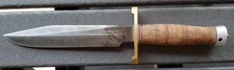

Phase 2 is to remove the Randall gleaming finish from the blade, guard, and butt. This is done with small swirling strokes with a green Scotchbrite pad. Make a second pass swirling in the opposite direction.
You can reverse this step with machine buffing but it's time comsuming and don't get the blade caught in the buffing wheel.

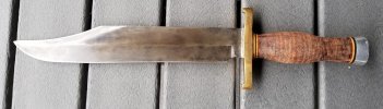

Phase 3 is applying a patina to the blade to "age" it. This is done by applying classic rust bluing which rusts the surface. Stop the process by rinsing with hot water. Then gently remove the rust and scale with that same Scotchbrite pad. I stop here and wipe the blade with oil. Note it's possible to go back but it requires a goot rust remover followed by polishing.
If you wanted a rich old fashioned gun blue finish you would remove the rust with a "carding brush" (fine soft steel) apply the blue solution and repeat the process thre or more times. Finally oil it.

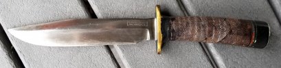

I completed my 1-8 today. Pics show rough checkering, checkering with beeswax applied, and the whole knife. Not pretty but higly serviceable. You can deepen checkering with a V shaped riffling file if you choose. You could also do a much prettier job than this if wanted to make it a project using wood checkering as a guide.
