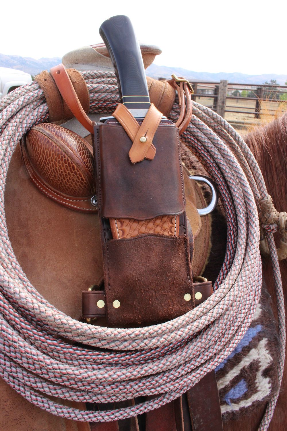

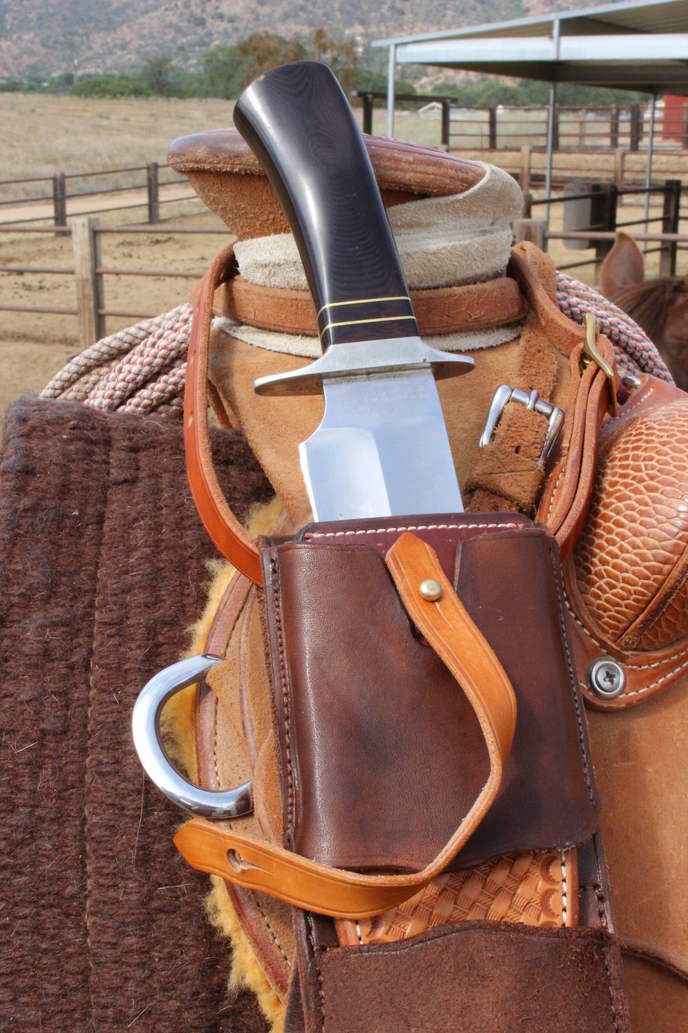

I have a friend in AK that does a lot of horsepacking. He likes to keep a large (AG Russell) bowie on his saddle. Years ago I made him a large variation of my pancake sheath and a device to suspend the knife and sheath from the rear billet of his saddle. This has worked very well for him over the years. Recently he got a new saddle and in order to save weight the saddlemaker did away the rear billets altogether. This is an old style of rigging thats new again called a centerfire rigged saddle. Problem is no place to hang his knife. So he sent me the knife to see what I could come up with in order to hang the knife from the saddle horn. After much thought this is what I did.
So basically its a three part system: a regular sheath for the bowie with a bowtie retainer strap. An enhanced frog with a cartridge belt sized belt loop on the back and a pocket at the bottom for the tip of the sheath to fit into. There are also "D" rings attached at the bottom so that the assembly can be tied down to the saddle or to the leg even if carried on a cartridge belt. And a heavy strap that fits through the belt loop of the frog and goes around the saddle horn. This strap has a buckle so that it can be removed completely or the height from the horn that the assembly hangs can be adjusted.
I was pretty happy with this soloution. It works. What do ya think?
Very cool. I love the frog concept, where the sheathed knife can be removed in an instant if the rider dismounts. Does the frog have a retention device for the sheath or is it just held by gravity? I'm just wondering in case the horse decides to lay down (or falls), which happens. Again, beautiful work and a cool solution to the problem:thumbup:

Thanks guys! jdk there is a lot of friction holding the sheath into the sleeve of the frog, its a very tight fit. As is the pocket part for the tip too. To remove it I took the knife out first and then pushed and pulled with both hands to get er out. The vagaries of equestrian life will not affect it. A guy can jump all the cricks he needs to and will still have his knife. Yep Vilepossum same guy. Also who I made those leggings for in that other thread.
Yep! there will be six inches of ice all over hell before that sheath comes out of that frog, plus the grain side interior of the upper part will further enhance the friction stickies……and the average horse is more careful where it puts its feet than I am.

Paul I should of mentioned they ride those Kieger mustangs too. I've ridden a bunch of mustangs and they don't stumble and thats for sure. Never ridden a Kiieger though. Thanks guys! Strig those are tubular rivets. The kind that open like flower petals on the back side.

I noticed AG's (modeled after an 1860's Bowie he examined) knife immediately
and just have to say what a sweet rig you have set up for it. :thumbup:

Thanks Doug. As a knife maker I was intrigued by the bowie's complex hollow grinds and how well they were executed. It was a pretty cool knife.

Great work! I'd have never thought of it being on the horn. By chance, do you happen to know what precise model the Bowie it is?
Nice sheath, particularly like the stud fastener on the retaining strap. AG originally called it the Bear Bowie did a couple of runs if I recall, mine is from 2003 and has a 7.5 in blade and I seem to remember there was one slightly larger. The grinds are both unique and beautiful. Enjoyed your photography, horses and pretty country. Do you still make the flapped holsters?
