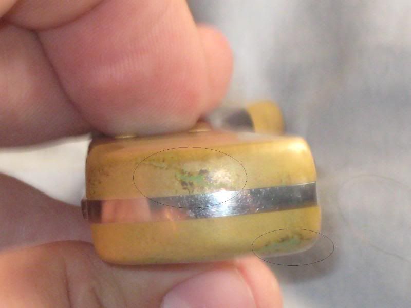

So I bought a buck 110 about 2 months ago and I don't use it alot although I do want to start EDCing it soon. I opened it today and found rust on the blade D: I cleaned it off but is there anything I can do to prevent this from happening often?

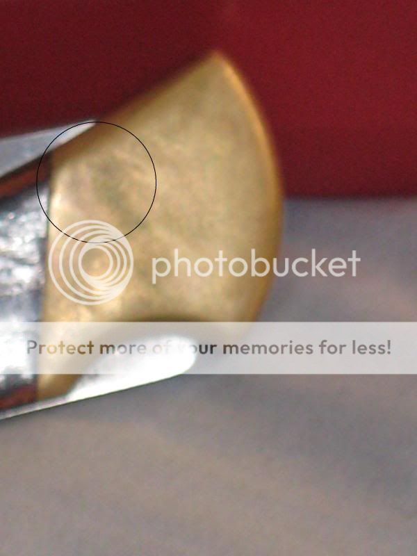

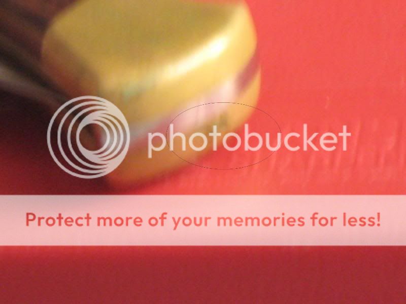

Also there is green stuff, plumberdv said it may be tarnish, on the lower bolster and I need some advice on how to take it off, he gave me a few suggestions I just want to know what alot of people say.

I scrub mine with Brasso, then with warm water and liquid soap, rinse it clean, then wipe it down with oil.
dont worry about it. wearing/ carrying/ using will take care of those little blemish marks. really. :D
Brasso like Bear said. There is something else some guys like called Fliz or something like that. Thing is you'll loose that nice patina. Try a some warm water on a rag and a thumnail.
i use flitz! :D
it works great and puts a real nice polish on it. it can be used on almost all metals i believe so even the blade can be cleaned with the stuff.
if you wanna keep that patina on there you could take a little bit of oil on a clean cloth and rub the trouble spots to remove the green tarnish.
i like to keep mine shiny but over the years i've realized that i can never keep them that clean if i use them on a regular basis or leave it in sheath for a while.

Products like Flitz and Simichrome work great, but are somewhat expensive. Brasso works well also, and is cheaper, but always seemed to me to be a bit more abrasive. Really, almost any metal polishing compound will do the job. However, if you store the knife in a leather sheath, that green stuff (known as verdigris) will reappear. Its caused by the brass reacting with the tanic acid in the leather. The tanic acid is used in the leather tanning process; a process which (go figure) gets its name from the tanic acid (or so my old chemistry instuctor told me once upon a time).
