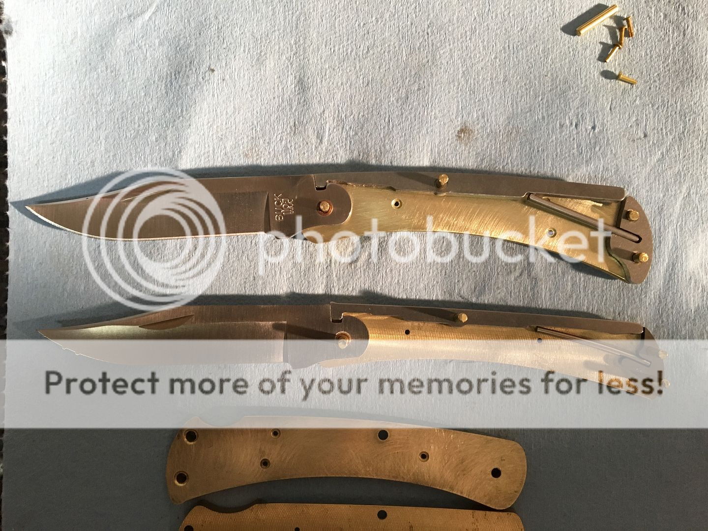

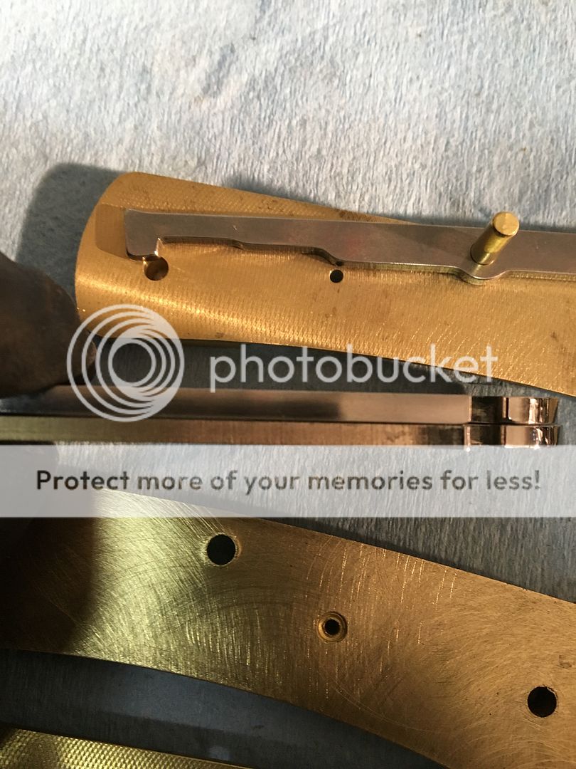

The difference between the Federal replica and the modern 110 is pretty drastic. These photos are from the Federal replica, not an original V1V1, mechanically, the original was quite different. I can't offer details as there are folks far more knowledgeable than I on the topic.
The top knife in the photo is a modern 110, the other is a Federal replica. The frame, spring holder (rear spacer), spring, and blade on the Federal replica are all smaller, thinner, narrower, etc...
As Bert mentioned, the blades of the V1V1 were thinner as well. I don't remember exactly what I mic'd them at but I believe the standard 110 is .120" and the Federal replica was .118". It doesn't seem like much, but see for yourself: Modern on top...
