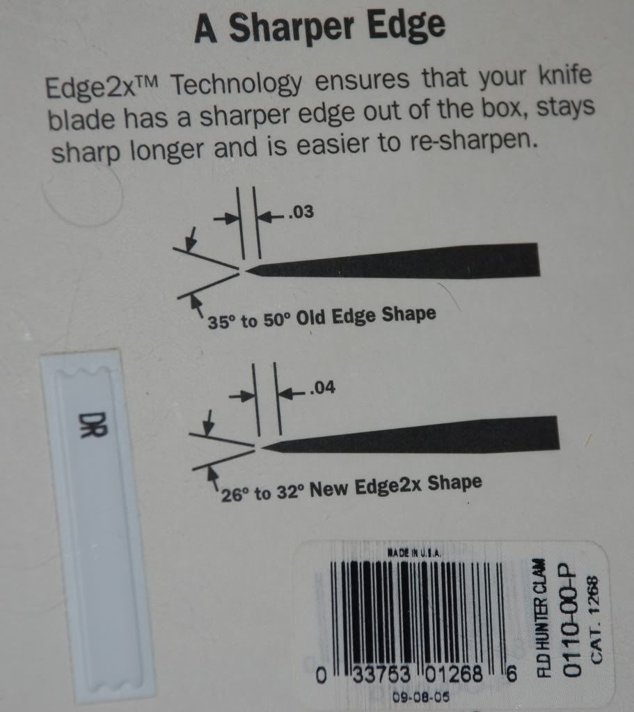

I'm not sure the answer is simple and may depend upon vintage. I do remember this blurb on sharpening angles from the year 2000 catalog. I'm primarily a collector so I don't sharpen many except my users. I recall David Martin has posted in the past on sharpening and perhaps he or someone else with real experience will opinionate.
Thanks Sky for finding this writing. Yes, a goniometer can get it more accurate than the angles above. What I've noticed is the 1970's knives were 20-21* (primary bevel) and the edge 2000 type knives are 17-18*. Gents who are concerned about angles normally have a sharpening devise with set angles and they want to know which setting to use.
Mark the bevel with a black marker prior and then try the 18* setting for a stroke or two and see if that is duplicating the original edge bevel. DM
Thank you gentlemen-I just sharpened my Bucklite to 18* and was getting ready to sharpen a friends 110 and was wondering what the factory starts with,I'll set his at 18 also,thanks again!

19 & Mark, yes I take most of my user knives to 15* per side and haven't noticed edge issues during use. (Been doing this for about 6 years.) This includes cutting thru chicken leg bones & thighs, pruning thumb size oak limbs, cutting zip ties, sisal rope ect.. I'm not gentle on my knives. I expect them to cut stuff. But I don't mallet. Going to this angle has muchly improved the cutting performance. I've not noticed any difference among steels. They all take (Buck steels) it rather well and perform accordingly. I've also given this angle to meat cutters knives I sharpen. (I sharpen several of these each week) They didn't know it and at returning I ask them how did their knife cut. "Great', is usually the response. They didn't know the edge angle but noticed how it cut. These guys aren't known for being gentle on their knives. Dedicate one knife, to try and see what you think. If the primary edge bevel on say a 110 or kitchen knife is 1/16" chances are the edge is at 18*. If the bevel sides are any wider the angle is more acute. Just a rule of thumb. I think at the heart of sharpening is the question; where is the 'sweet spot' on a steel? Where you increase cutting performance and maintain edge durability. DM

Pack, thanks for taking the time to post this photo. 15-13* is a range that I've read gents do on their knives without any issues. I haven't wanted to go that acute but I read it can be done without damage to the edge. Perhaps I'll try it. DM
