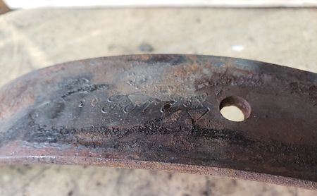

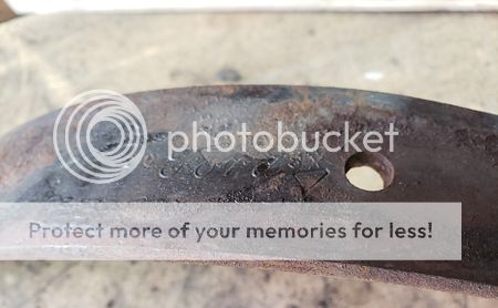

Upon disassembly of the leaf spring packs, I noticed an embossing on them: " Ford " pretty cool I thought. There was plans then to save the logo on a project, but I was not yet sure it's design.
Last week I was, and made the design come true with what I think are great results.

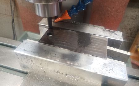

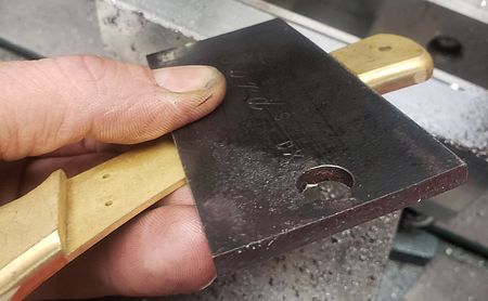

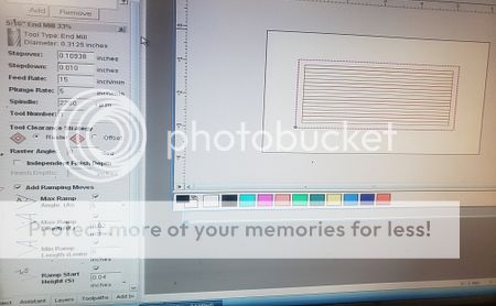

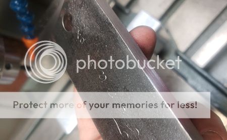

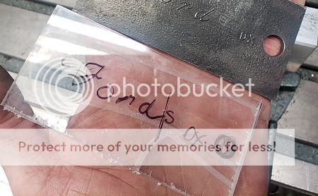

I first had to straighten and anneal the spring in my forge without damaging the embossing. Then the edges were CNC squared, and faced to thickness. I drew an oversize scale and used a test piece of Lexan to superimpose the script in the ideal location for a 110 scale.

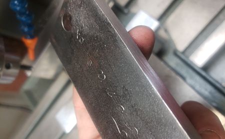

Transverse Leaf spring
Straightened ( somehow to within .025" without damaging the embossing ) and sawn

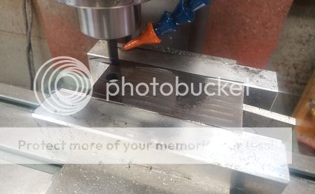

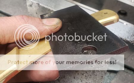

Edges faced for clamping

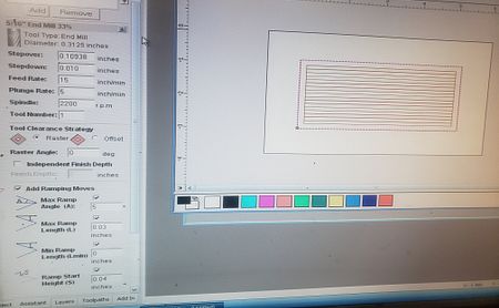

Facing program
At Thickness
Test piece
Rough shape program. I left it a bit big to give room to hand fit
