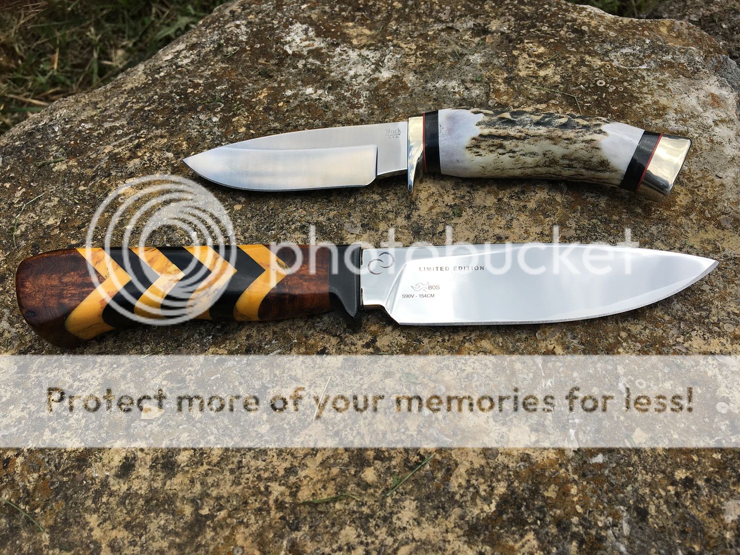

I have one. just got it a week or so ago. I think it was the last that knifecenter.com had. Jeff H at Buck insinuated that they have only one left.
I love it! To the point that it might just be my go-to hunting knife (if I don't return it that is). Crazy, right? That's what the wife said anyway... lol It's going to be competing with my BG42 Vanguard for heavier cutting but I doubt it will replace my 118 for dressing deer and smaller.
The handle is exceptionally comfortable. It's narrow at the blade end and near twice the thickness at the end. For me, it fits like a glove!

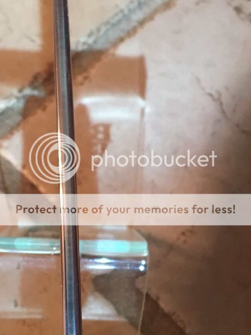

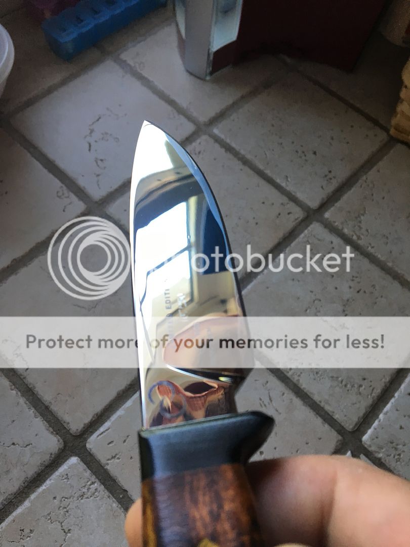

The issue I have with it is that the grind on the left side shows the transition very well and even, but the grind on the right is much less appealing. The cutting edge is still S90V and because it's relatively center of the blade thickness I don't believe the cutting edge will ever be the 154CM.
That is the sole reason I'm debating whether to keep it or return it. Jeff H at Buck explained that it's a product of the manufacturing process. They don't know how consistent the thickness of the center is until they start grinding the profile. I understand that, but they never should have left the factory like that. Not at that price point anyway...
The rarity is what I'm struggling with. If KC had more, I would exchange it, but they told me it sounded like a manufacturer's defect and I should discuss it with Buck, though they were happy send me a postage paid return label in the event I did want to send it back.
In my opinion, design be damned they should have seen the problem and switched to non-laminated S90V blade stock. Shame on Buck for making this beauty one sided!

I see the issue, and while I don't think you're being unreasonable at all it wouldn't bother me personally. So now I think I have to find and buy one of these. Thanks!
I need to add though that I have seen examples of the Yellow Jacket with acceptable grinds on both sides, so you could get lucky. The problem though is that it's very unlikely that a dealer is going to open the sealed and numbered box to check it for you.
Yes, the transition lines on the Spitfire aren't really perfect, but they're acceptable!
I withheld the issue in my SPS post because I was hoping there was a solution, but alas there is none. Other than returning and buying from others until I find one suitable.
I really love it otherwise. Great size, great shape, great steel, great handle shape, etc... I just expected more symmetry in a knife with a high price tag...
I love the way it looks, and it's just the right size and in a great steel. I think I have to have one now that I've seen it. Your pictures are only making me want one more than I did already, it's gorgeous. ;)
You won't be disappointed! I think it's the nicest fixed blade to come from buck in many years.

MT, I would be very bothered by the way that blade turned out. Can Buck fix that right side? They will have to grind it a bit, and re-polish it, but surely they can do that, wouldn't you think?
I was thinking the same thing Doc. Perhaps Jeff H will chime in on the topic.
I expect though that the waves in the transition are consistent on the right side throughout because the blade is straight as an arrow. More grinding isn't going to help a poorly stacked laminated steel.
Even then, wouldn't regrinding the blade affect the heat treat? It would ultimately mean them completely reworking the blade, re-etching and polishing the whole thing over. I don't see them going through that much trouble....
