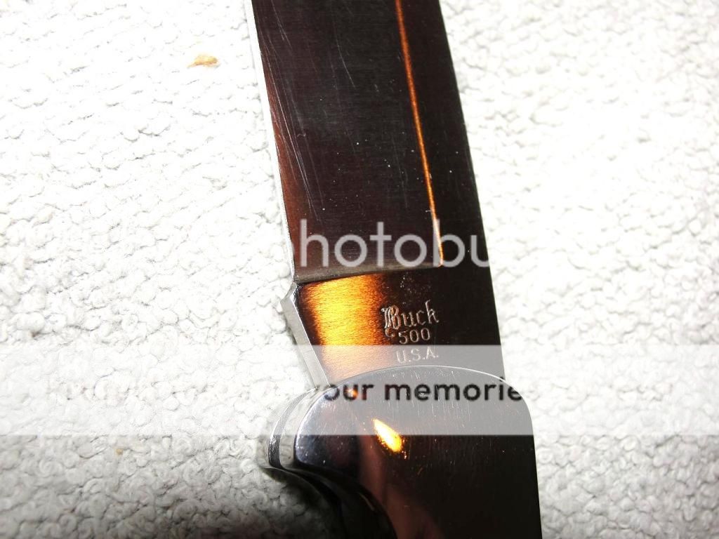

The only other issue was the blade had about a millimeter or so of lateral play in it. I'll admit it,....I'm a bit fussy and nitpicking here,.....but 35 years as a bench jeweler/diamond setter made me that way. :rolleyes:
For SURE we're looking at a great "canvas" here, and I certainly can't expect a huge amount of custom finishing be done on such a bargain priced and practical knife,.......straight out of the box. On sale at $40.00 shipped on ebay,.....a no brainer.
So OK, I look at some forum posts here and decide the blade play removal is something I can do myself. So I grab a piece of 1/8" thick scrap leather and fold it to pad the jaws of my small jewelers vice, make sure I'm centered over the blade pivot rivet (and not catching some of the rosewood scales), ....and slowly tighten the vise until I felt a hint of movement.

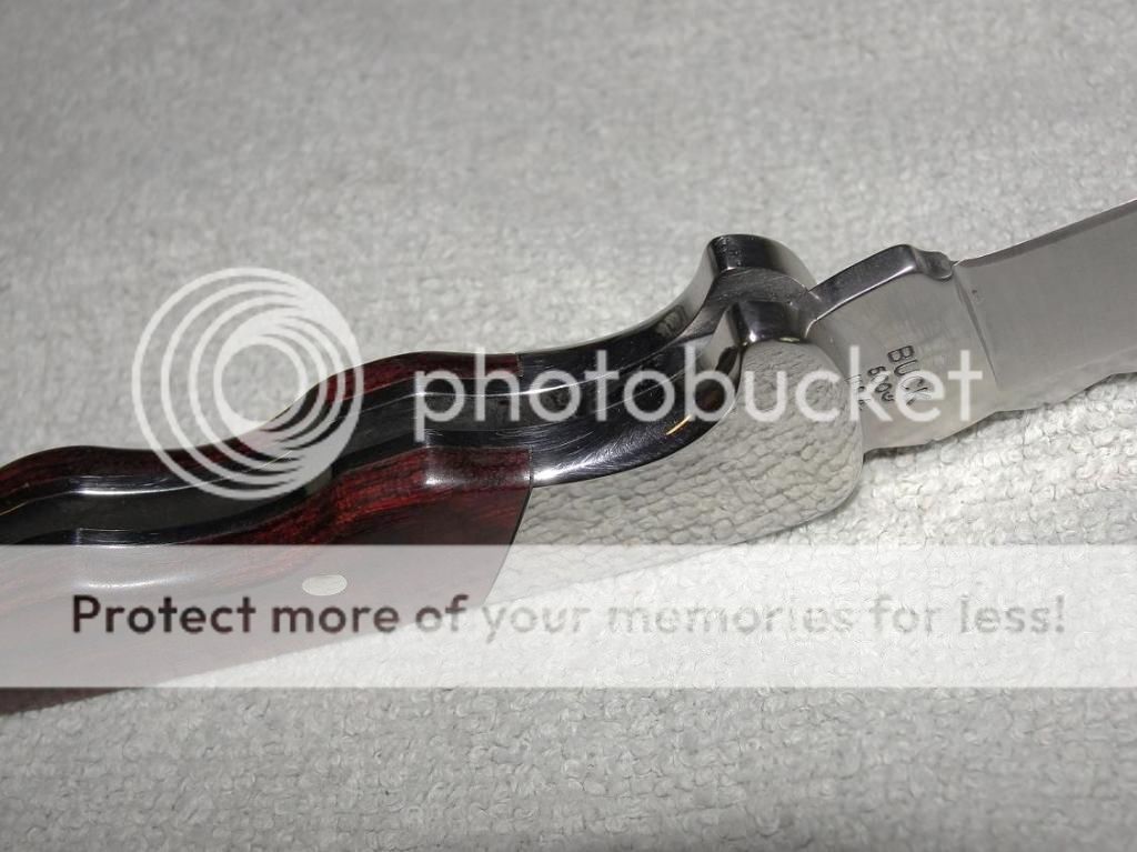

Removed the knife from the vise and could see just one side of the blade rivet was now protruding a smidge, and ALL of the lateral play was now gone! I used a steel staking punch to carefully tap down the rivet after padding the back side with just a business card against a scrap steel piece that I added a slightly cupped surface to match the surface contours of the bolster/rivet area. Some light sanding and crocus cloth followed by a 1" muslin wheel polish and that was done. The blade was actually a smidge tighter than I preferred, but opening and closing the knife a few hundred times made it about perfect. (and still no play in the blade)

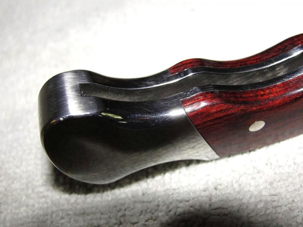

I decided to get rid of all the sharp corners next, and that was pretty simple using a 1/2" rubber backed cylinder sanding disc using 120 grit disc. I finished up with a few finer grits by hand, and finally used the small polishing wheel until it felt S M O O T H :)

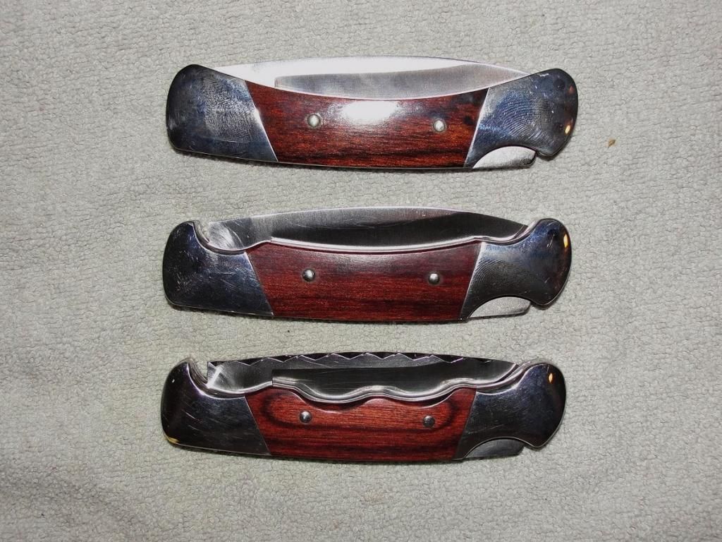

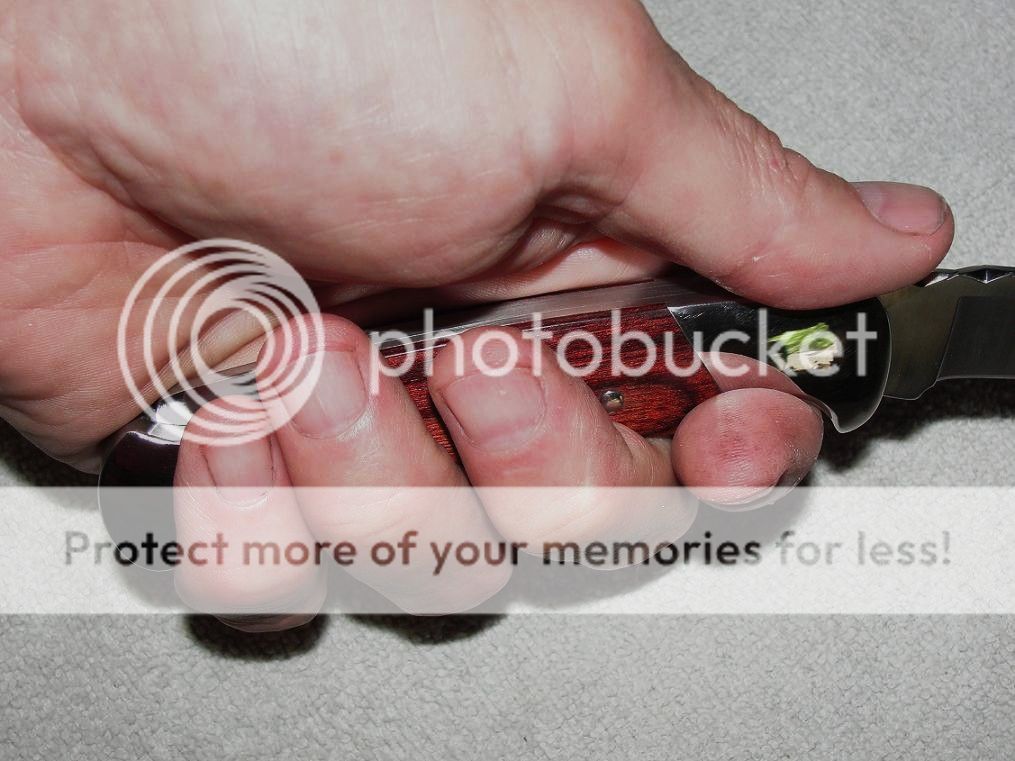

So OK, smooth corners and tight blade lockup,....but something was still missing in my mind. Most of my other Buck folders I have added custom fitted finger grooves. But those were all done on brass bolsters,....and THIS one had stainless steel to contend with!
I'd remembered reading on the making of stainless steel bicycle frames the time it took to make was about DOUBLE that of chromoly steel ones. AND,...the stainless had a tendency to wear out cutters a lot quicker!
So OK, most of my jewelers diamond burs I'd long ago abused cutting out a frozen bottom bracket on a bike rescue buy of a Serotta road bike frame. But I DID have lots of sanding discs and stone cut off discs at hand. I decided to put 3 thin stone cutoff discs on the spindle to increase the surface area to be removed on my Foredom Flexable shaft machine (a glorified Dremmel).
That worked fine,...but also VERY SLOW in this monster metal! Grind a few seconds, dip in water to keep cool, repeat. Folks, it took me about THREE HOURS to get where I wanted to be on this knife on just the finger grooves! :eek: (blade tightening and edge rounding an additional 1/2 hour or so)
Once I got close with the tripled up cut off discs, I finished up with the rubber backed 1/2" sander and 120 grit, followed by hand finishing to about 800 grit to a final polish. The outer corners of each finger groove has a comfy taper to them, and each groove placement was centered over my own hand. I suspect this will fit the majority of users in any case as my hand is about average.

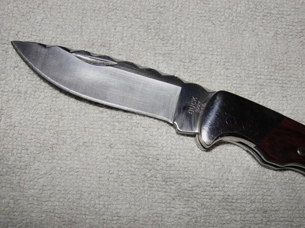

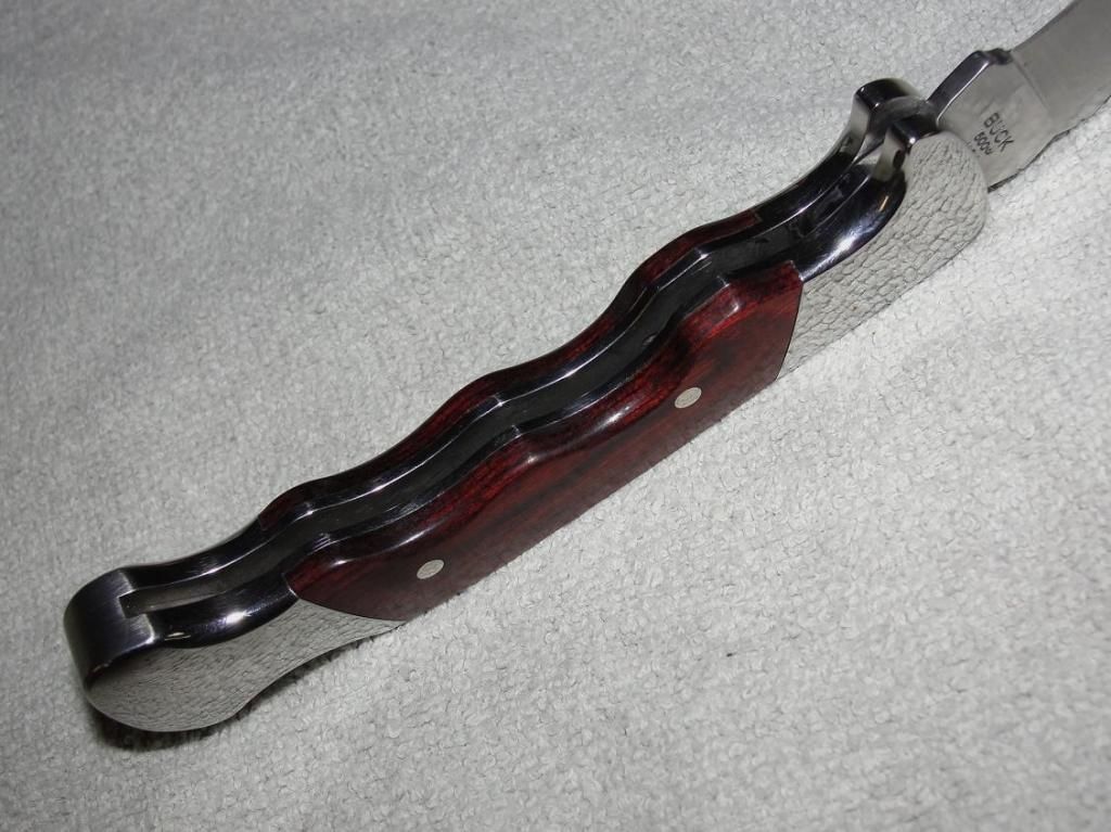

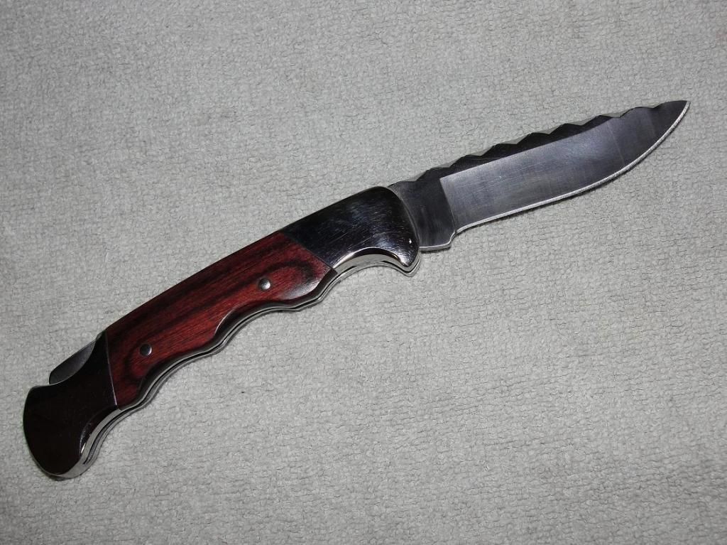

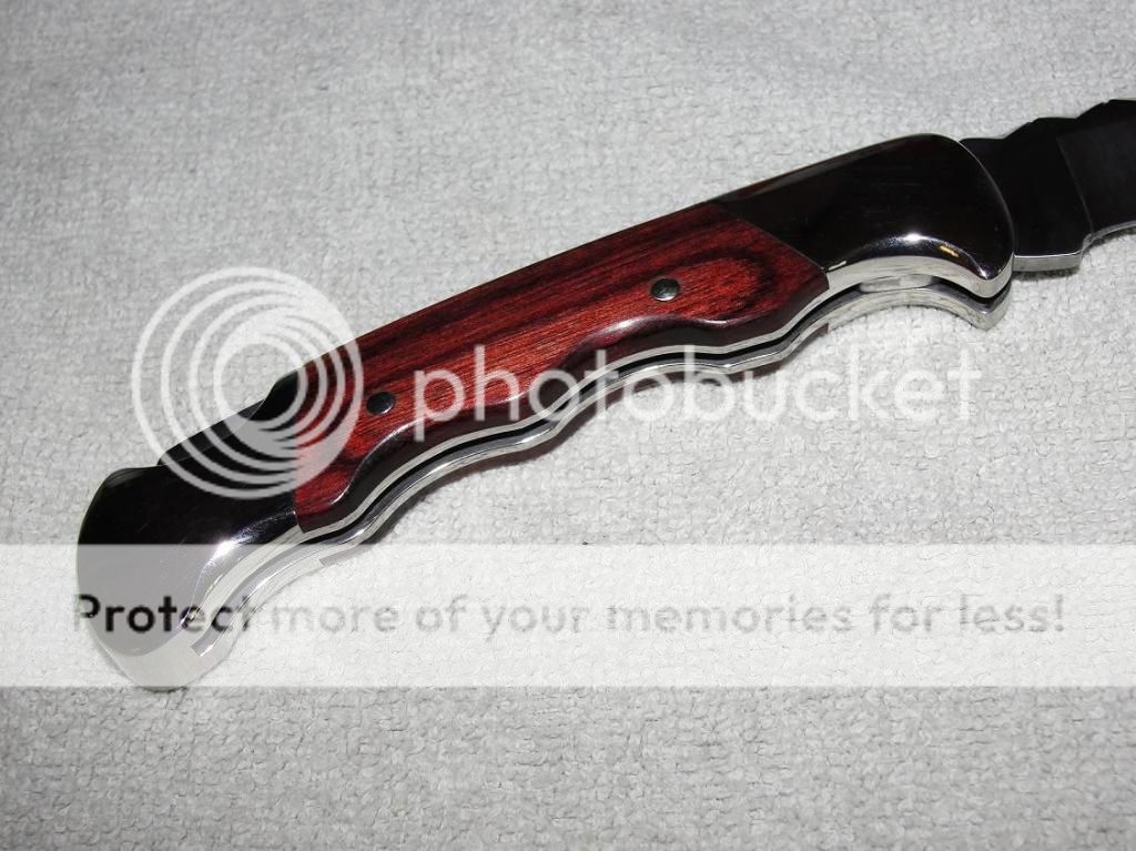

Anyway, I'll include some pics below that I think will show the result. An added bonus is the knife dropped about 1/2 ounce in weight, and feels great in the hand. It's become one of my favorites to carry in my pocket. I quickly stitched together a small leather dust cover to help keep the works clean for pocket carry. An added hole will allow for neck carry under a T-shirt or tie to you belt for added security on a fishing boat and such.

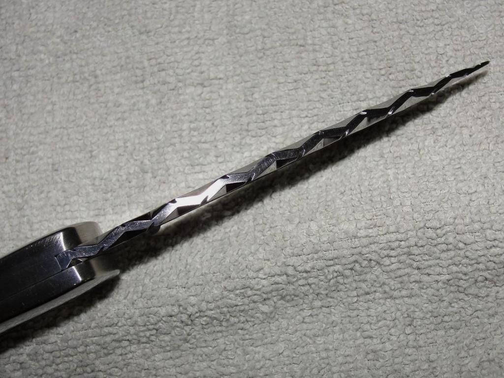

Oh,...I later perfectly leveled the top of the locking bar flush with the frame, and added a little love on top of the blade,.....just felt like it. :D
All gone over and she got a good cleaning in dish detergent and heavy streaming water and brushes, followed by about 80 PSI of blowing out with my air compressor followed. I used a light oil on the blade pivot and lock bar pivot, and some moly paste at the blade lockup and where the post spring meets the lock bar areas.
.....I think I'm done with this one now,...and she feels sweet in hand! Yeah Baby!!! :D

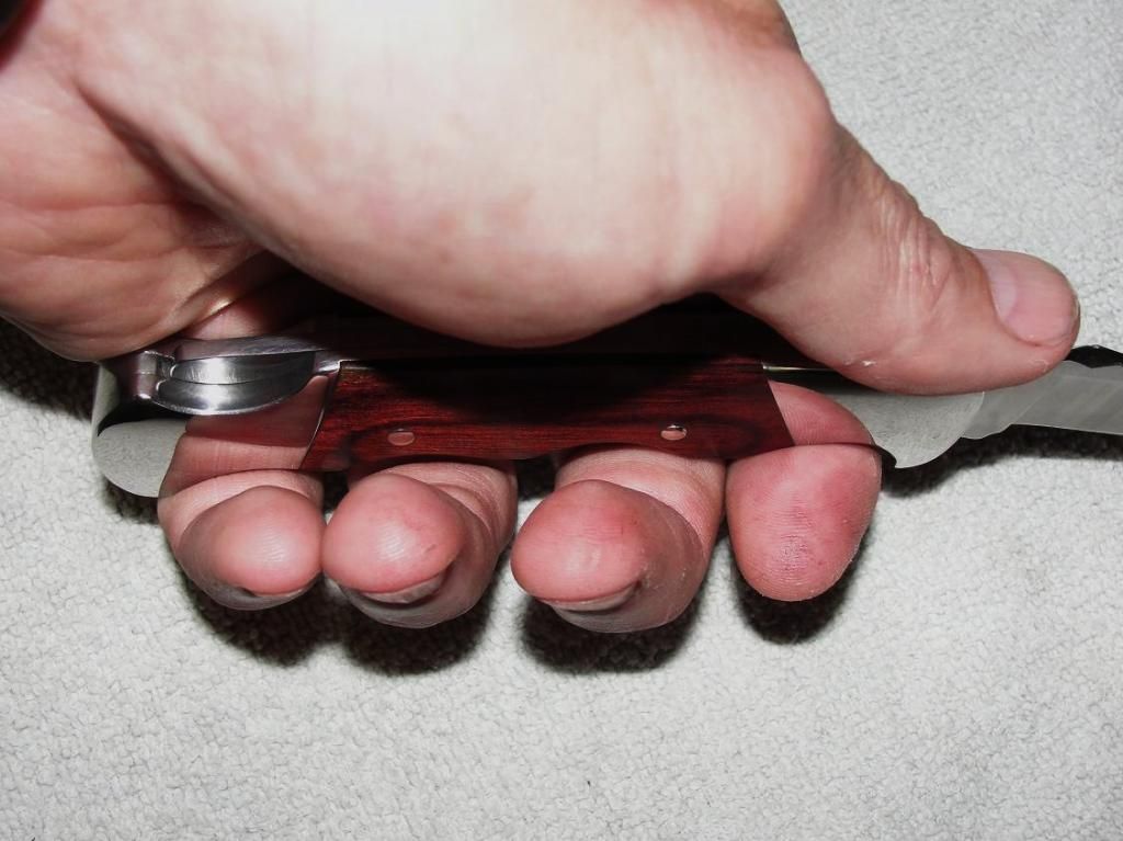

NOTE: One wish is that Buck would offer this knife optionally WITHOUT a nail cutout. It's a beautifully shaped blade, and with the added finger groves there is no need for the nail groove There is PLENTY of blade to grab onto to open her up. The old 2 dot 112's look so much better without that groove,.....but the clip point not a favorite of mine. The 500 Duke drop point blade is mighty fine otherwise.
The index finger groove stops right at the bottom of the blade structure that tensions the blade in the closed position. Do NOT cut into that area!

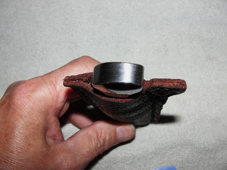

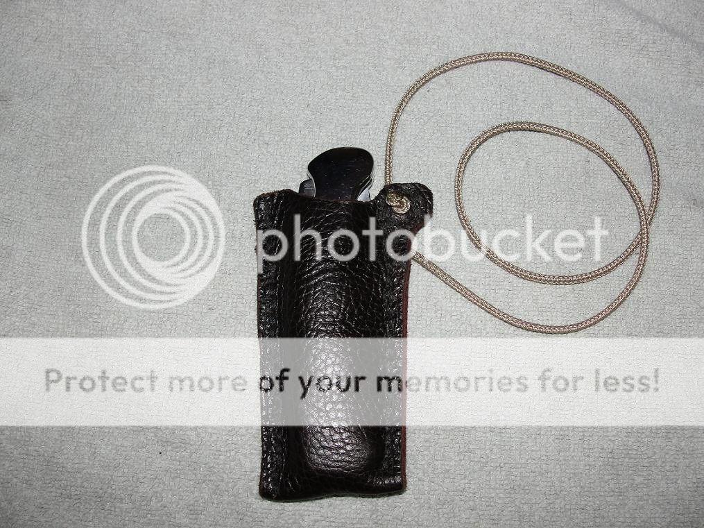

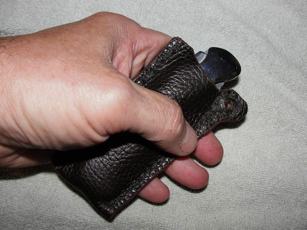

A good fit and the knife placed in the cover this way (blade pivot DOWN) keeps most of the dirt out while pocketed:

Thanks, and like anything the end result is what you put into it. By the way, my factory applied finger grooved 110 from about 15 years ago has MUCH shallower grooves, but it's a bit much for me to carry everyday so I haven't changed them.
In some ways on a knife this size the deeper finger grooves actually HELP to keep the blade from slipping around when wet, or bloody cleaning fish or game. The original factory polished bolsters were pretty slick in hand, and the sharp edges didn't help either as you really didn't want to grip it all too tightly! The added finger grooves sort of lock the knife in position to your hand, and for me at least a big preference on this knife that I plan to carry regularly and use under all conditions.

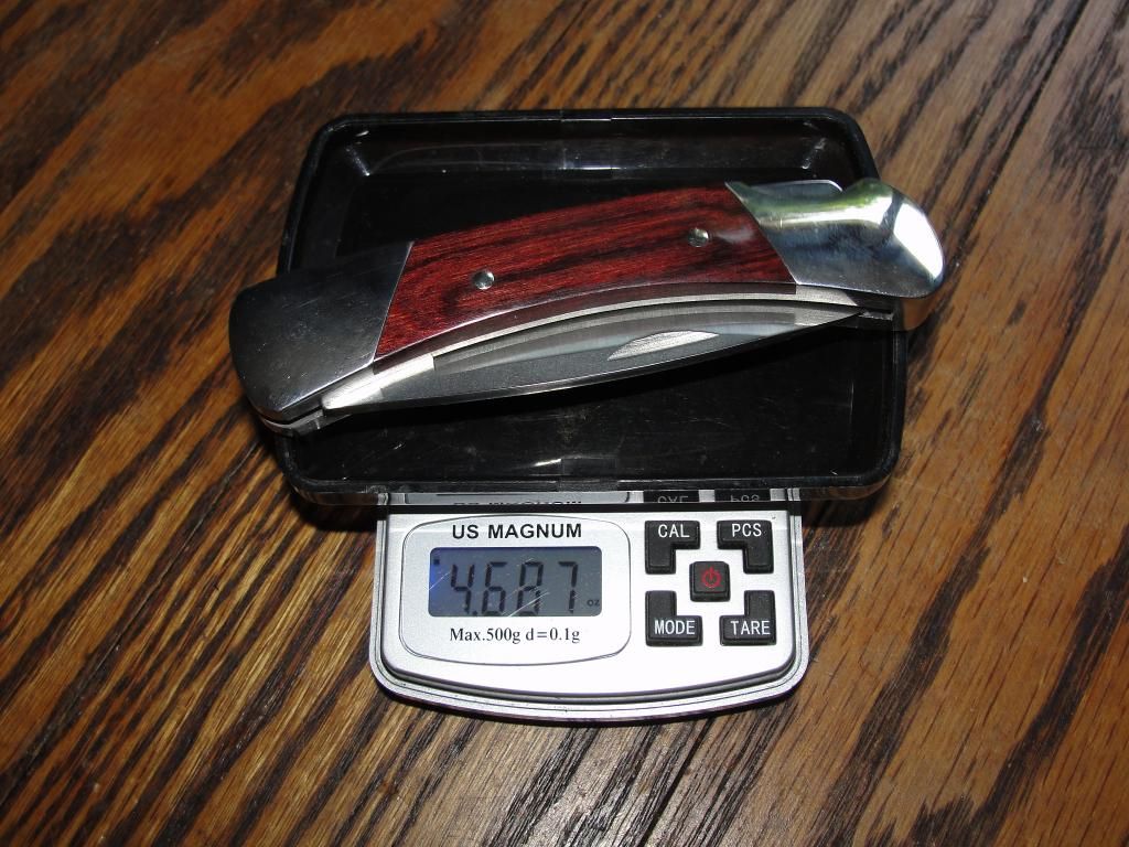

The only picture I took before starting work on this newer 2014 vintage 500 was to record the weight. You can see some sharp edges, but I wasn't trying to emphasize the edges so the photo probably doesn't convey the best of what the hand felt. :-)

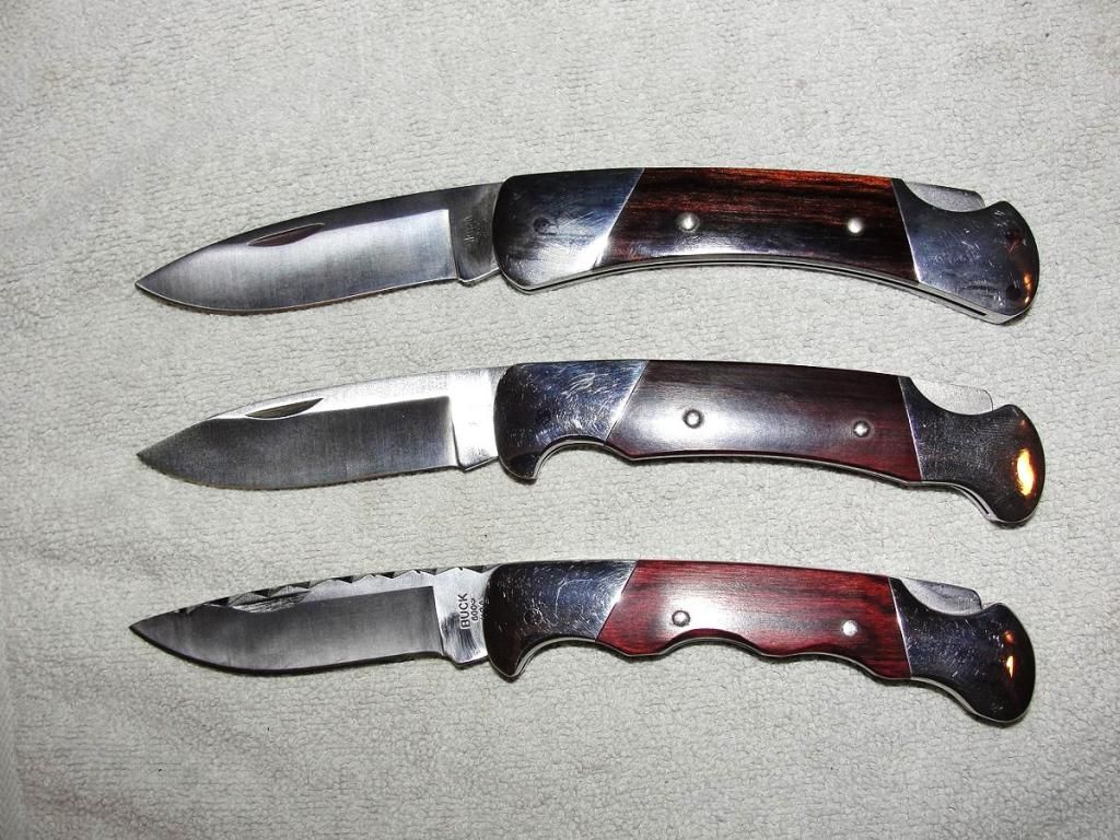

I know what I like and am a bit picky. :rolleyes: Once I got in my two older 500's with Script lettering, I decided to leave the newest looking one alone as stock. One had a bit of use on it, (and left some very small battle scars unpolished) so I'm sure to use it but needed at least an index and picky finger groove which I added. I left the center alone as I may try to add stag scales to it once I find the right set and wanted the most stag showing possible.
The index finger groove (on 2 grooved knife) is not as long as the 4-grooved 500 for a similar reason,....maximum stag coverage when I get around to it :D The thin scale edges, especially at the lock bar side, will be tricky if I want to maintain the outer "skin" details of the stag.

I like the looks of #2, grooving the bolsters straightens out the grip and looks like it gives more usable length.
