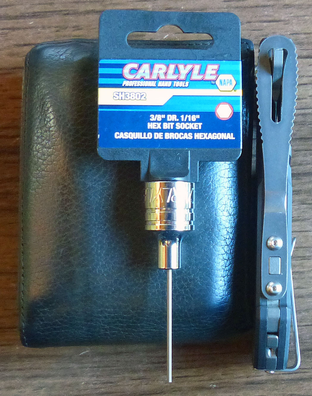

The negative on this front are what I consider to be cheap pot metal screws that hold the strap lock in place. These are located on the top of the strap lock. When adjusting the strap lock one must be very careful not to over tighten these screws, they will distort and strip if not careful. I have replacement screws being sent from Buck free of charge. The strap lock screws need to be hardened, plain and simple. Another negative, is that the blade stop pin is metal inserted into an Aluminum handle. Metal beats steel, and thus after hard use the stop pin will wiggle slightly. This can be compensated by loosening the top two strap lock screws, and slightly tightening the strap lock adjustment screw, followed by tightening back up the strap lock screws.

Tools needed for disassembly:
-Pivot: T10
-Handle screws & pocket clip screws: T6
-2 Strap Lock screws: 1/16'' Hex
-1 Strap Lock adjustment screw: .050'' Hex
