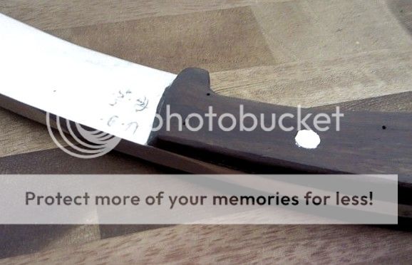

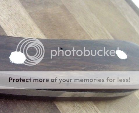

bugs eating wood handle!
Dec 6, 2004
1,241
I just received this knife, the sender swears there was no damage when he mailed it, so upon seeing these insect boring holes I assume there may be live bugs actively eating the wood. How can I be sure to kill the bugs before filling and repairing the damage? My first priority is to kill any bugs so they won't spread and start eating any other wood items!
The handle is probably infested with wood beetles. 2 months ago, after seeing some powdery saw dust and holes in an olive wood piece (natural - i.e. untreated), I sliced up the wood and found 3 beetles and a dozen tunnels. oh I did tried to kill these buggers before slice up the wood: heat, pesticide, sub-merge in water - all failed. I still have no clue how & when these beetles got there.
Heat should kill any remaining bugs- put the knife in the oven at 135 degrees F for an hour. Hopefully the prolonged temperature won't affect the laha or wood.
edit - did you notice any fine sawdust in the packaging when you unwrapped the knife?

I'd tap the handle to make sure there's no dust comming from the holes and then have it sit on some white paper for a few days to see if there's dust coming from the holes.
If so there likely are bugs in there. When not, then not and fill them with ca of epoxy or so.
But I agree the maker should do this
If it's beetles you should be seeing sawdust. it looks like drill bit holes to me though. Anyway, I'd dip it in boiling water for a minute or so.
Looks like a Himalayan Imports piece to me. If Auntie or the seller can't/won't help, shoot me a message if you want. I'd be happy to help you rehandle it, if nobody else will.

Heat treating to internal temperature of 135 degrees F for 30 minutes is required to kill all insects for international shipping of wooden crates and pallets, so it should worry fine for killing any remaining critters in your knife.
OT -do you smoke the frozen cigars after they thaw?
What you are seeing can be fairly common with Ebony.
We fight with powder post beetles throughout Oregon and California.
The 3 ways to kill them are;
heat - 140f for at least 4 hours
cold - in the freezer 3+ days
poison - apply liberally and seal in a plastic bag so the fumes penetrate the wood, not just the surface.
I like the cold treatment best as it is less likely to cause damage to the wood.
I would not microwave the wood. Some woods will combust internally (don't ask how I know) and you don't know until you see smoke coming out of the bug holes.
