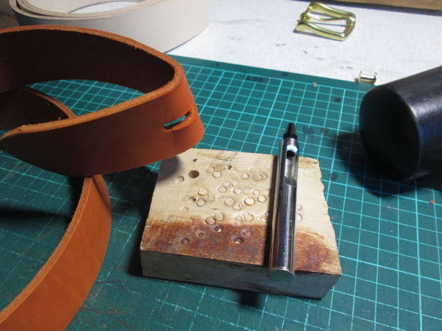

Further groove for the stitching on back side, and punch the holes. I used 2mm diamond hole punch.

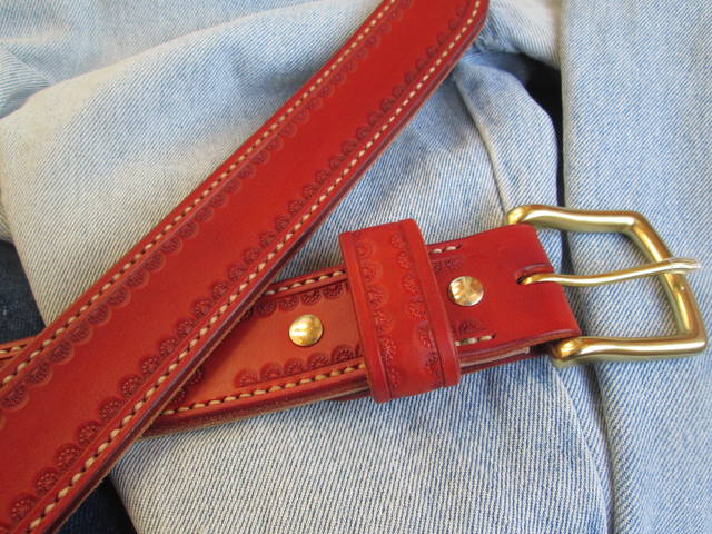

After that the belt is ready to stitch. I took about 10 meters 1 mm thikness waxed thread for this belt. After the stitching I got two ends about 40 cm lenght.

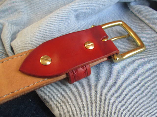

Cut all the edges. Install the screws in right place. Use the keeper strap for it.

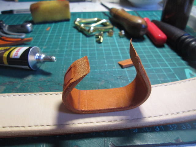

Make the keeper

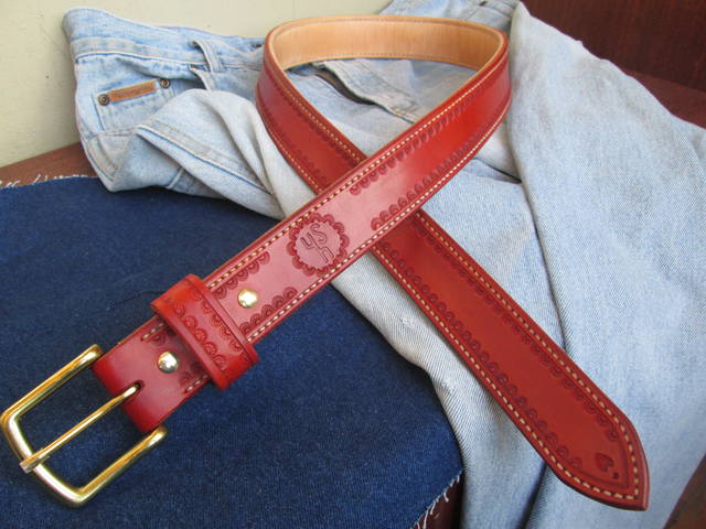

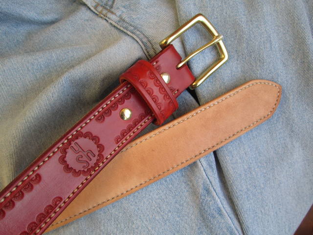

Glue and install the rivet. Further burn all edges with some kind of slicker and I use the gum tragakanth for it and wax. Treat whole belt with neatsfoot oil and give some time to soak. For finish treatment I used balm atom wax. Polish with piece of denim. Assemble all parts of the belt. Done.
No tongue holes because my friend doesn't yet to come :)
Thanks for watching.
