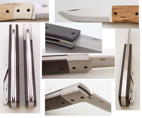

OK, you don't want "cheap" meaning the knife may fail or have crap steel for the blade.
There are very high quality knife kits nowadays where the materials are top notch, the design is excellent and you can customize it to take whatever look you want.
Here's an EnZo PK70 knife kit with options of wood, G10 and carbon fiber scales. EnZo is a well-respected knife brand from Europe. You can find others.
Thanks for the tips. I looked around for that Enzo and only seem to find it as a complete knife, the kits are out of stock everywhere. I did find a Laguiole kit, but it's a slip joint and he wants a lock back. The hunt continues!
