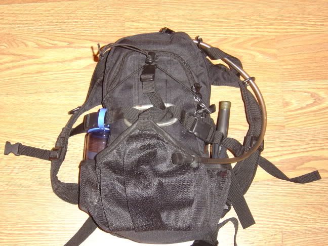

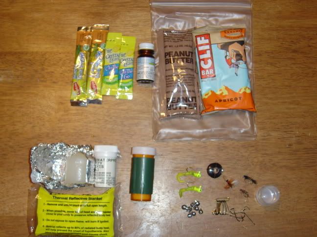

Here's my son's kit he's used in the past:

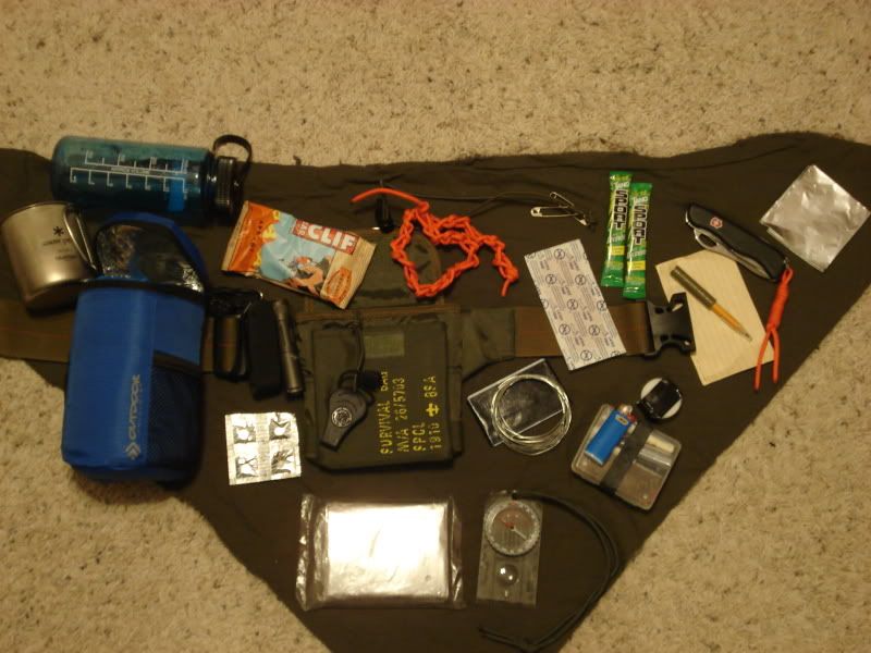

Now that we are doing more backpacking and he's a little bigger (just turned 12), he uses a small belt kit:
Of course, his knife-choices have change a bit, but he always has a pocket knife, LED light and whistle:
ROCK6
