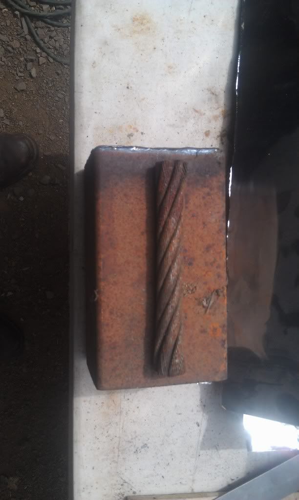

I will post a quick WIP here on cable in a can. I do not have pictures of the burning out of the cable. Basically cut you cable to the length of the can minus the end caps. My end caps are 3/8 inch. Here is a picture of the cut cable and a 4x4x.125 square tube.
After cutting enough to fit into the can as tight as possible do a burn out of the cable. Run the forge low, like in the 1200-1500f range if possible. The idea is to burn the oil/tar/creosote mixture out without getting the cable too hot. There will be a lot of flame out the front of the forge if you are using propane. Let it burn until the flames pretty much disappear.

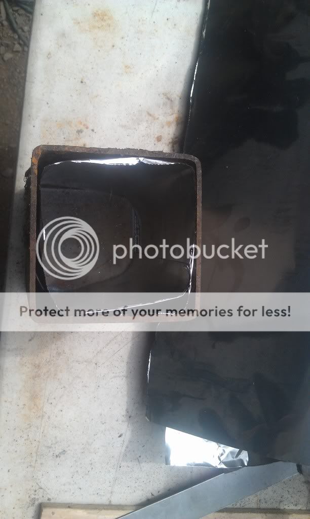

I assume the box has already been prepped. I usually use 6-3/4 inch long box so I can cut 6 inch cable. In the picture above you can just see the bottom has already been welded in. I did line this box with stainless steel foil. I have found it does not really do much beyond make it easier to see when you have gotten all the can removed. I usually do not use the foil.
