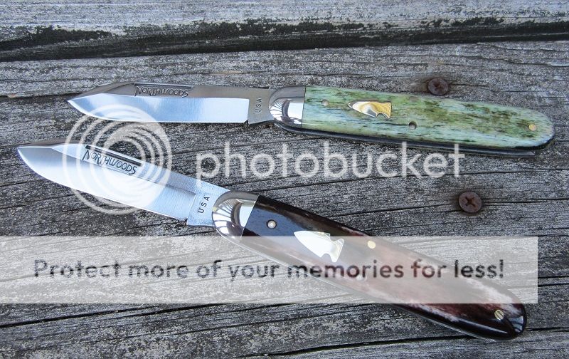

Shaggy, those colours look superb! Seems to really take to smooth finish although the recent Schatt Big Jack has jigged.

Camel bone is more dense, and more expensive. The reason I choose it for the Northwoods is that I LOVE how differently it takes the dye.
Thanks for your replies Will and Derrick! it does take dye nicely! And as another member stated,it kind of like an Appaloosa effect which is very nice.
