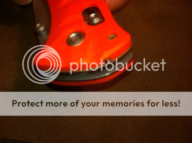

I have tested my carbide glass breaker fitted on a MOD CQD Mark 2 with bare hands before, and glass managed to scratch the aluminum alloy surface.

Let's see, Blackhawk has the CQD Mark 2 series, Benchmade has the Contego and Kershaw has the red Blur, all of them should have glass breakers attached.

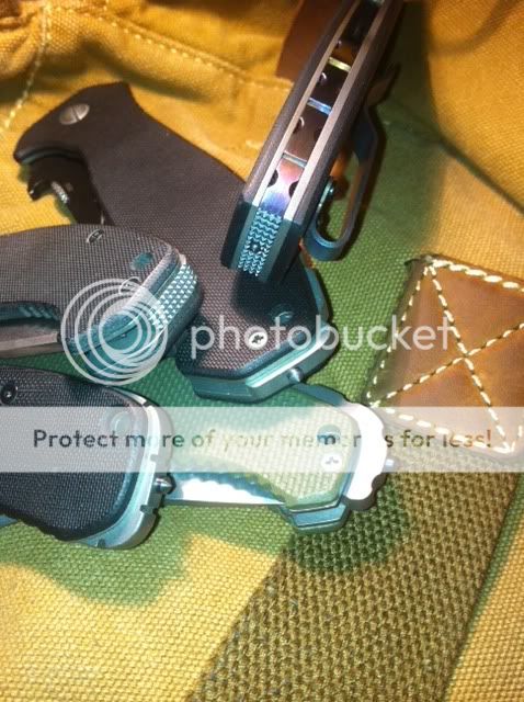

I recently picked up a BM houdini pro and think it is an excellent well made tool for a very reasonable price, spring loaded glass punch, seatbelt cutter and flashlight rolled into one. I hope i never have to use it but it could save a life in the right, or should I say wrong situation. BM also makes a smaller version as well, the pro model is basically the size of a large folder, but I have never held one for comparison. Of course the downside is the lack of a standard knife blade on it which would make it even better in my opinion, something like the mariner or rescue style sheepsfoot blades would be a perfect addition.

I edc a BM915 and it works well.
