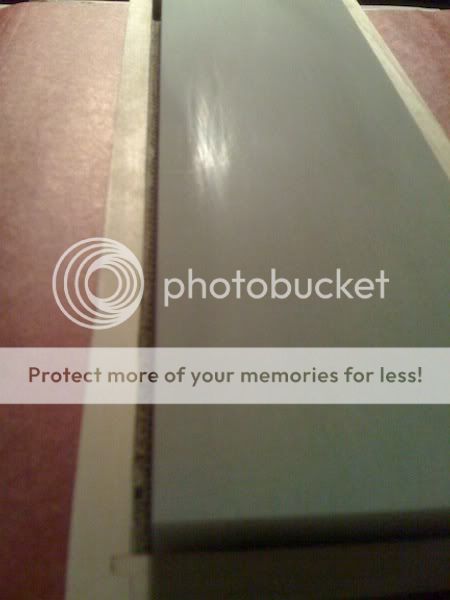

Water is the ONLY thing I will use on mine. I started out with oil stones. I'm just a water stone person. I spend most all my time on Shapton Pros. That said most of the steel I sharpen is not particularly rust crazy. Some of the o1 steel blades people have or similar plain carbon steel, that will rust while you stare at it. Rinse it under hot water, dry it and it is quite rusty. Sharpeing that stuff, I suppose, is a good argument for using kerosene rather than water, etc.
As far as clogging the stone that is the least of my worries. Most of the stuff I sharpen is so danged hard / alloyed that it makes the stone smoothed over and I have to dress the stone on diamond or on silicon oxide grit to get the stone cutting again. That'll "unclog it" sure. Second photo is a taste of what happens / stone smoothed and not cutting well. See the shiny area. The whole stone gets like that.
One warning : water in the stone can freeze and crack the stone or cause it to flake. "Oil" . . . kerosene or other sharpening fluid won't.
