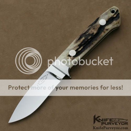

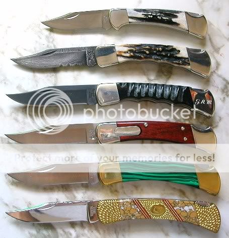

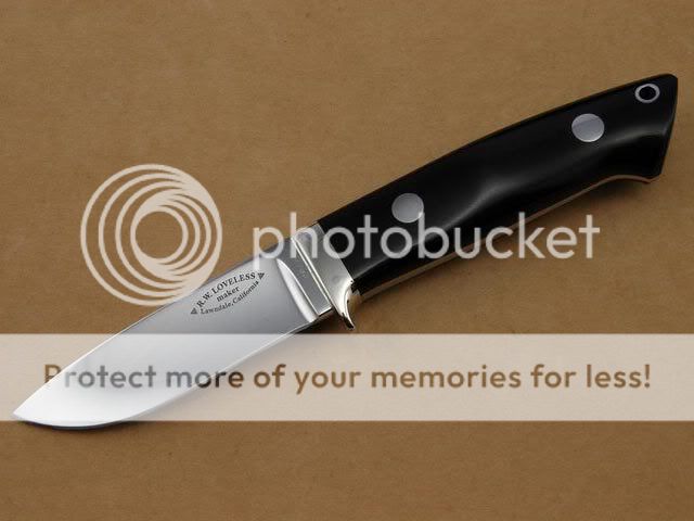

Ok, lets review...
Clip Point
Clip Point
Drop Point
Drop Point
Clip Pionts
Drop Point
Clip Point
Drop Point

In my opinion, the photos posted above by Ramm9 are true "Drop Point" blade shapes. I'm not sure why other styles are referred to occasionally as Drop Point blade shapes.

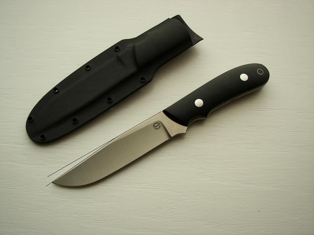

Is this a clip point or a drop point (Dozier professional guide knife)
That looks like a drop point to me. Ramm9 gave the best examples of classic clip and drop points. A clip point blade the spine of the blade curves up a little at the point. A drop point blade the spine is fairly straight from the handle and the spine drops slightly down towards the point.
You have to look closely, but it is a clip point.
I've added a couple of lines and you can see where the line of the spine breaks cleanly, forming an angle.
