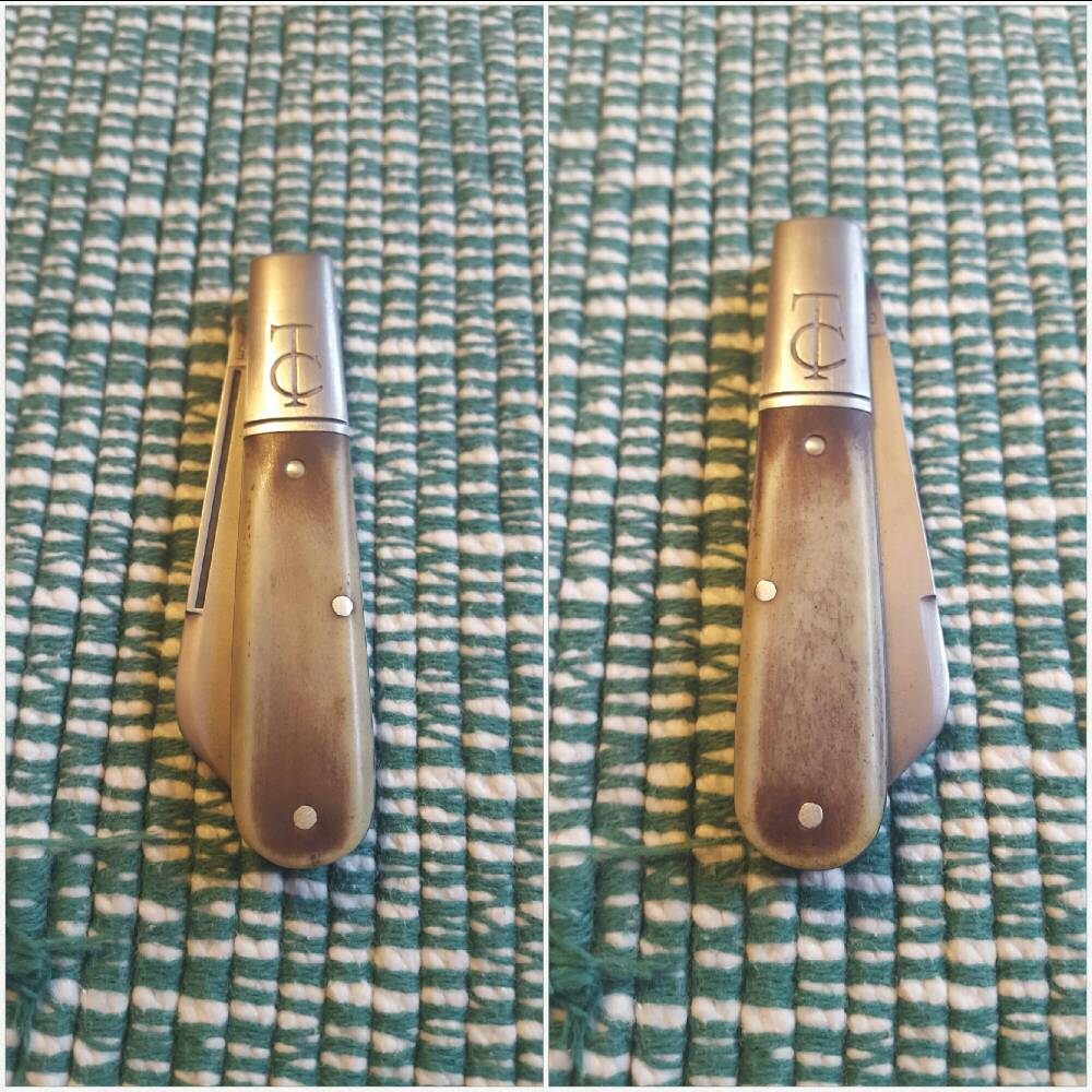

I dyed mine black
Because I tried the tea bath and it didn't come out looking good.

I dyed mine black
Great work ALLHSS! You're a brave man to dye a TC. It turned out great though!

I honestly regret it, despite it turning out well. I thought it was looking pretty haggard from use and carry, so I decided to try the tea bath. It looked AWFUL
I was pretty heartbroken. This was my first traditional I bought for myself and my first GEC. I decided to go all in and try black. It turned out to be an acceptable alternative.
I think the black looks classy, but I miss the smooth ivory bone.
