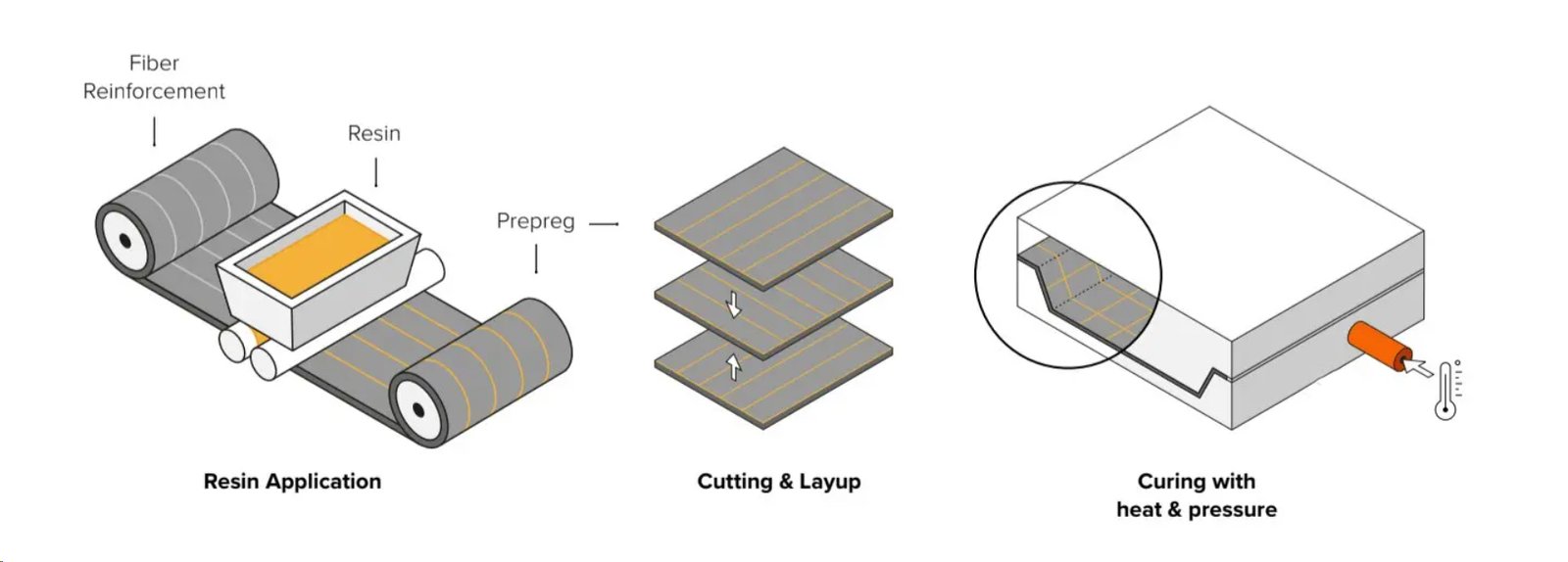

Carbo Ti is a bit different than standard Fatcarbon or CamoCarbon, but similar to Fatcarbon Spectral and CamoQuartz (confusing, I know).
Regular Fatcarbon and CamoCarbon are both high quality carbon fibers that use things like polymers and/or metals to give them a pop of color. The layers on Fatcarbon are roughly .2mm thick. I don't have an exact spec for CamoCarbon, but it's similar.
Spectral is a special recipe made by Fatcarbon that uses layers of carbon fiber that are .05mm thick, which is about four times thinner than the layers on their standard carbon fibers. This makes it ridiculously strong. So strong in fact that the material has been used as lockbar, and has had screws threaded directly into it with no inserts on production knives. It's crazy tough.
CamoQuartz also uses layers that are roughly .05mm thick. They use a blend of carbon fiber and quartz in their recipe, which gives it a look and makeup more similar to Northern Thin Ply Technology (NTPT) CarboQuartz, which is really hard to come by now that it's owned by Richard Mille watches.
Carbo Ti uses layers that are of a similar thickness to CamoQuartz/Spectral/CarboQuartz. I'm not sure if they use colored quartz, or some sort of polymer, etc for their colored layers though. It's reported to be super strong, so I assume they're not using quartz, and something more along the lines of what is used in the Spectral.
