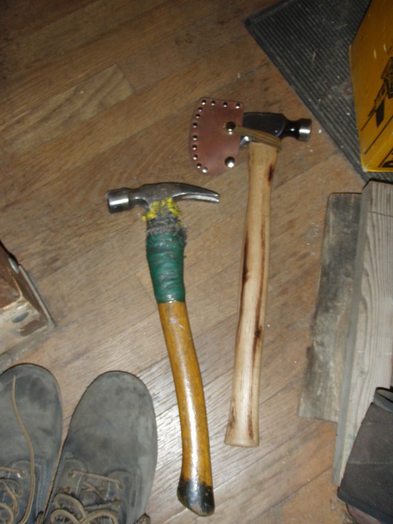

I use a modified riggers on a 18" handle for roughing out larger tenons and mortise housing while timber-framing.... It's also nice for knocking down knots on Red Pines that I peel for rafters and 3/4 round joists... it fits in my hammer holster so it part of my tool belt system when framing...

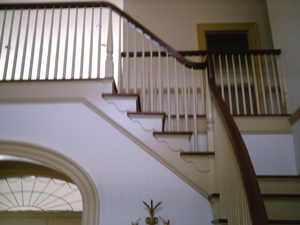

I used a hatchet to hew a couple of high spots off of the subfloor before I fitted the landing tread around the balcony of these stairs. I also used a hatchet as a slick to true a few of steps on the carriage before installing the treads. Being these stairs are curved, or flared, my hatchet came in handy fitting the curved sleeper carriage to the straight portion of the main case. I find a hatchet works best for fitting these steeply pitched bastard cuts. I keep a hatchet near me at all times for little tasks like I just mentioned. A hatchet is quick, efficient, and makes zero dust as compared to using a hand planer or belt sander to accomplish the same task.
I also find a hatchet handy in framing too. I find myself hewing crowns off joists, and headers on a regular basis. But, hey what do I know, I've only been building custom homes for 35 years.

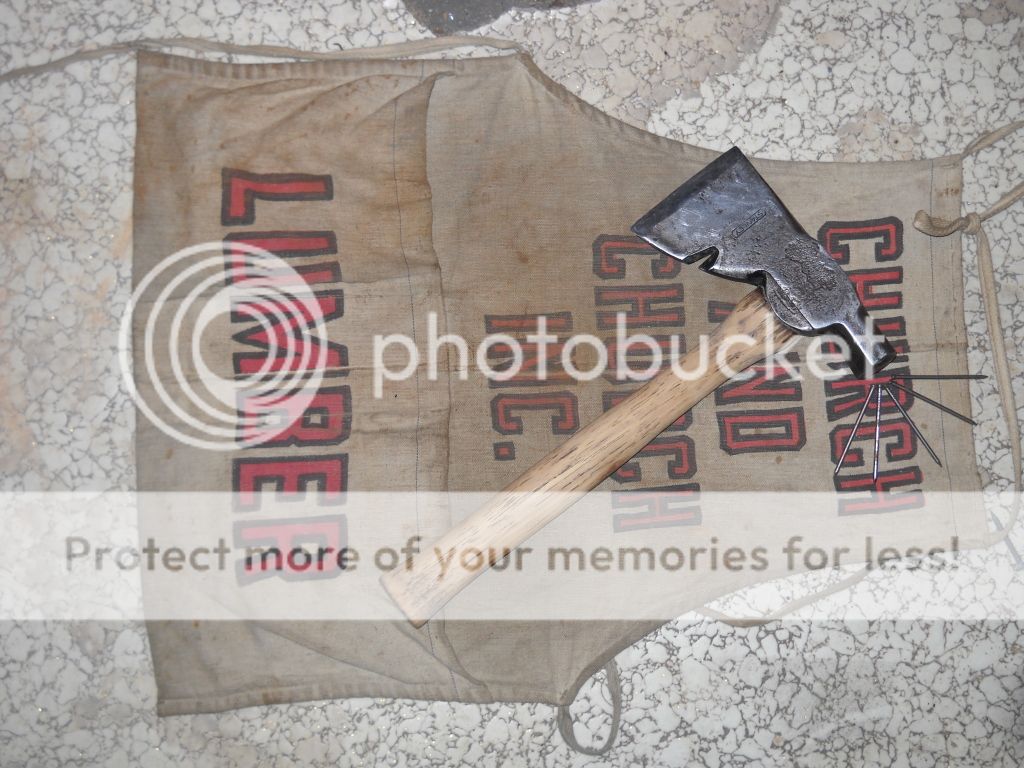

I swung a hammer for better than a decade, these days I turn more wrenches. But I picked one up specifically to keep at the shop for demolition duties on old pallets that I burn on occasion. The problem was, that my Plumb hatchet project turned out so nice, I don't want to beat it up!! :D But that is what I rebuilt it for. The old abused head came from e-bay, it was perfect for my intended purpose.
I think I'll take it in to work after all...

Wow, that looks really nice. How long is the handle?
