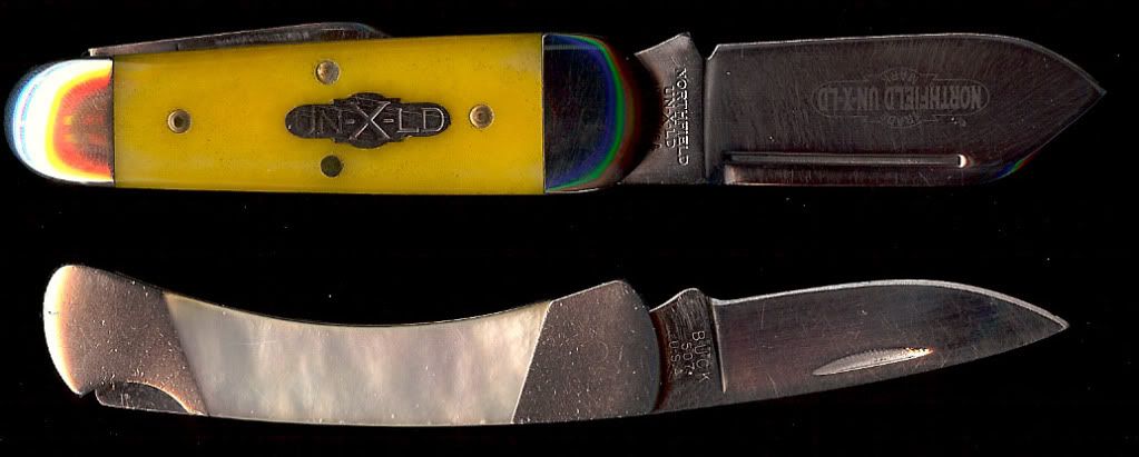

I think pearl is a lot tougher than folks seem to think. I have an old Buck 507 that a friend of mine picked up at an estate sale. The knife has obviously been carried in a pocket with keys or change, and used for years. The bolsters are beaten and chewed up, but the very thin pearl slabs are totally fine. The pearl is in way better condition than the metal bits of the knife, which to me indicates that it's fairly tough stuff. I've seen plenty of old knives with pearl on them, and it seems to wear well. I have a pearl Case Barlow that I've carried, used, and even dropped on hardwood floors a couple of times, and the pearl is still great.
Here's a pic of my well-worn pearl 507 that shows how well even very thin pearl slabs can hold up.

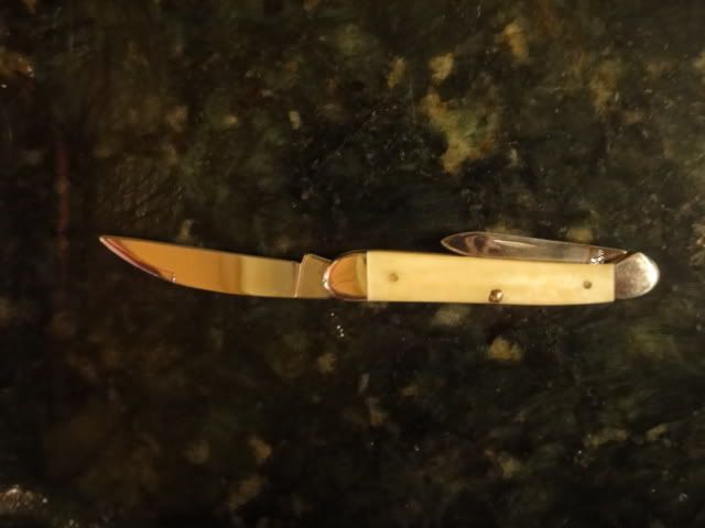

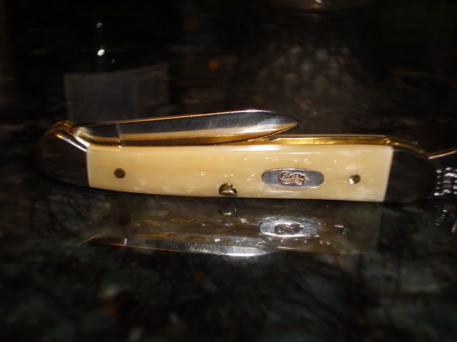

Will do. I bet the amber bone looks beautiful as well. Most of what I could find were the stag scales and I let the mother of pearl one get snatched up before I could make up my mind. I think I'll end up liking the natural just fine though.
Well, I got the knife in today and while I love the pattern and Wharncliffe size, I'm pretty bummed about Case's quality. The knife is going immediately back to Case as the pen blade has some play when opened and hits the liner when closing it. Enough to put nicks in the liner in a few diff. places. Pretty unacceptable for any knife at any price IMO.
