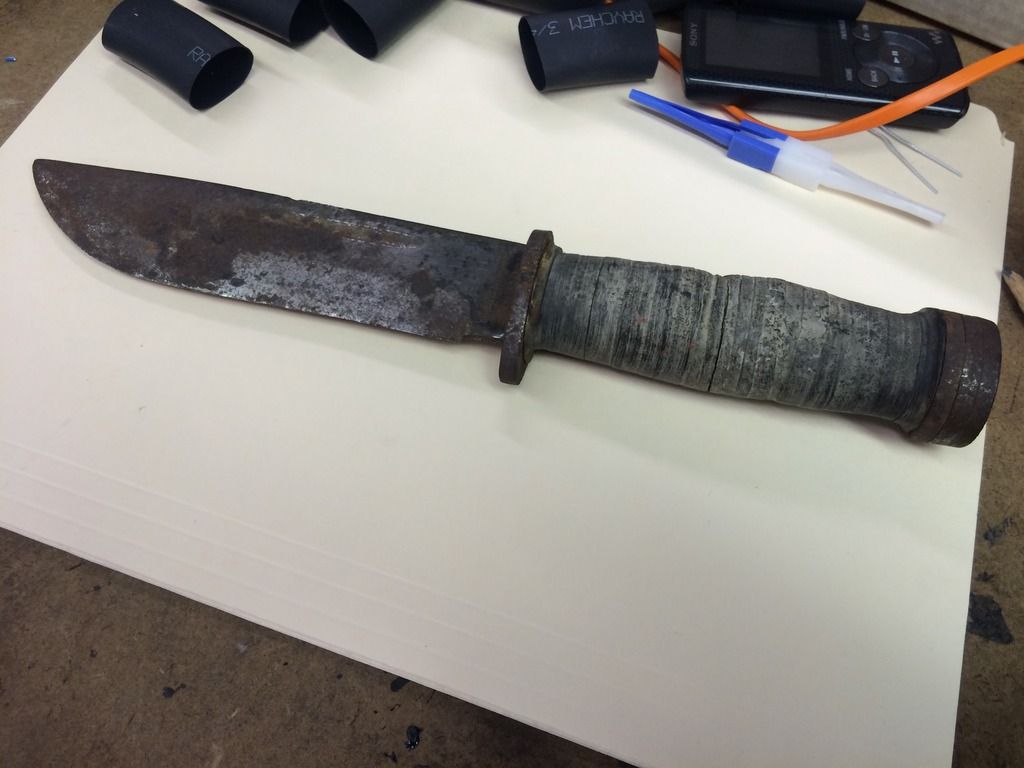

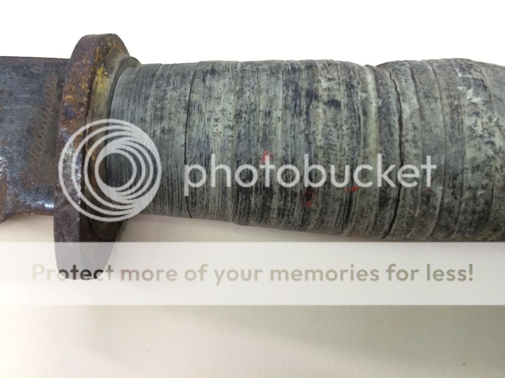

So i was a at auction today, and came across a rusty knife. Looked pretty neat. I was mainly interestednin what kind of steel the knife was. A guy I work with restore old knives, but only wants rusty ones because he isnt a stainless steel guy. Since the knive was legible I googled the numbers and manufactuer, and found it was the Cattaraugus 225Q. Found it to be a WW2 knife, So i bid on it, and got it for $2.
I would like to restore this as much as possible, and am curious if the leather can be taken off with damaging the leather. Its pretty dry, and pretty tight on the tang as well.

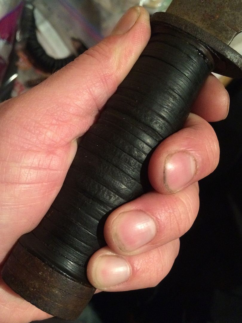

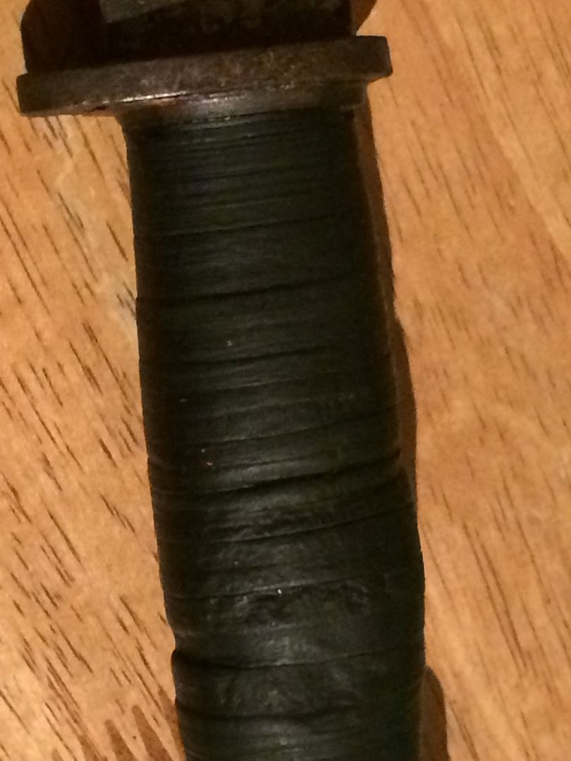

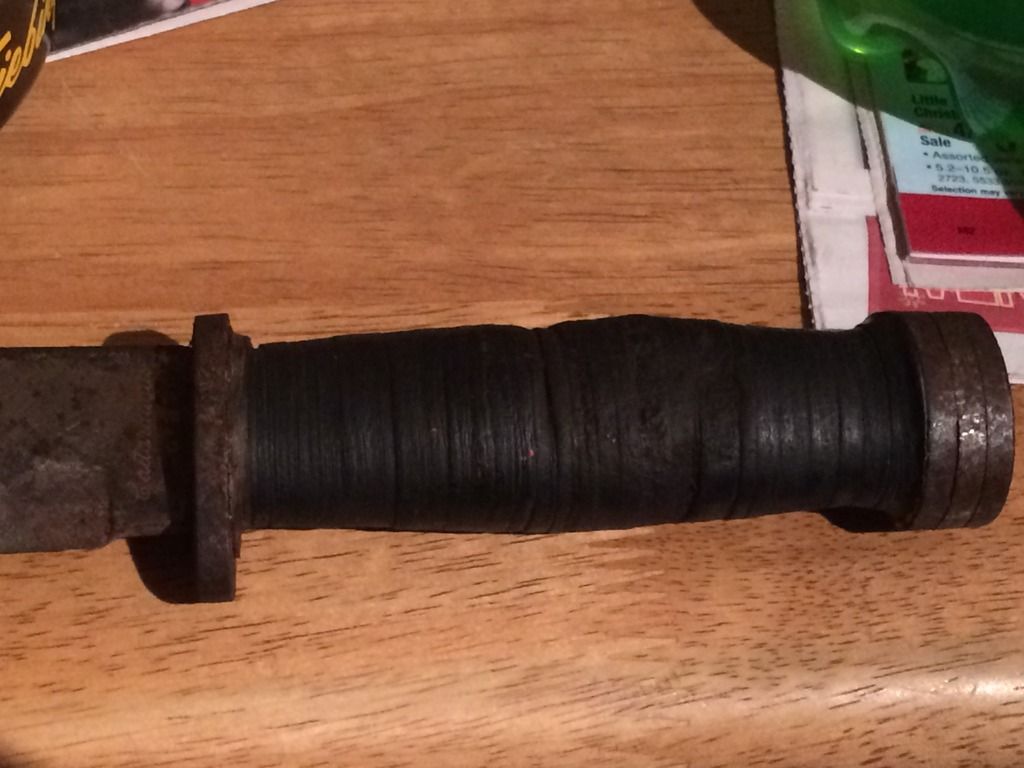

So i just spent the last day cleaning and oiling the leather handle on this knife. Here is the result! I may not replace this leather, just reglue it when I put it back on after cleaning the steel.
Or should i still replace it?
Before
[/URL]
[/URL]

If at all salvageable, keep the leather. You can always replace at a later date.
Ad some leather oil to soften/renew the leather.
If a user, dab the handle with SnoSeal, heat it gently with a heat gun or the wifes hair dryer.
