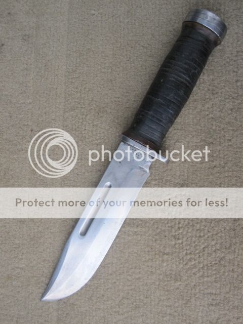

I have several with this one being my first 225Q and my favourite Cattaraugus by far:

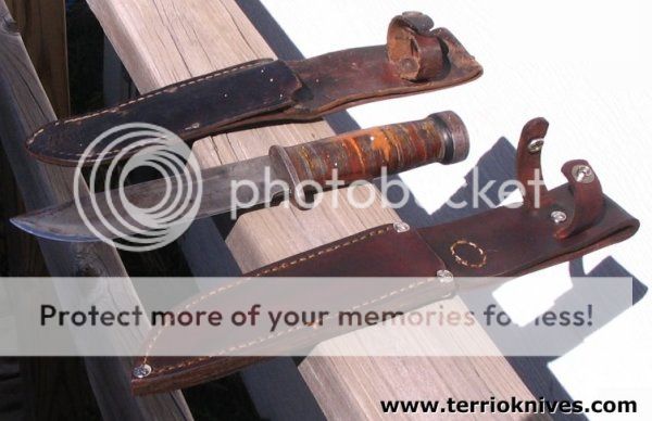

This one was brought to me by a woman whose father carried it "on every camping and fishing trip we ever went on" as she said. She wanted to pass it on to her son. I talked her out of a full restoration - it would have cost her nearly as much as a new custom. Like yours, it was in very solid shape so all I did was clean it with 0000, wipe a little neatsfoot oil on the handle, touch up the edge and make her a new sheath. It was a fun and easy project, and still carries decades of Grandpa's patina. :thumbup:

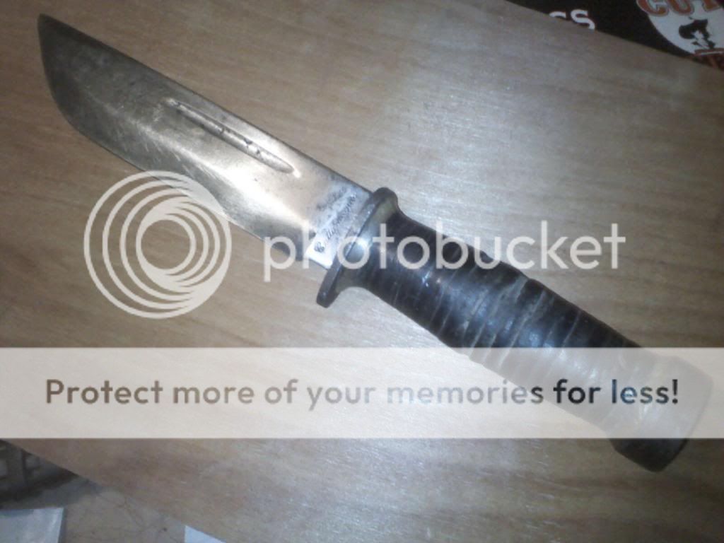

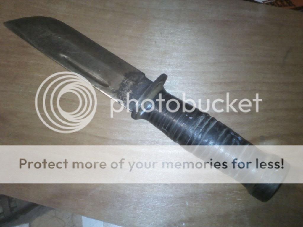

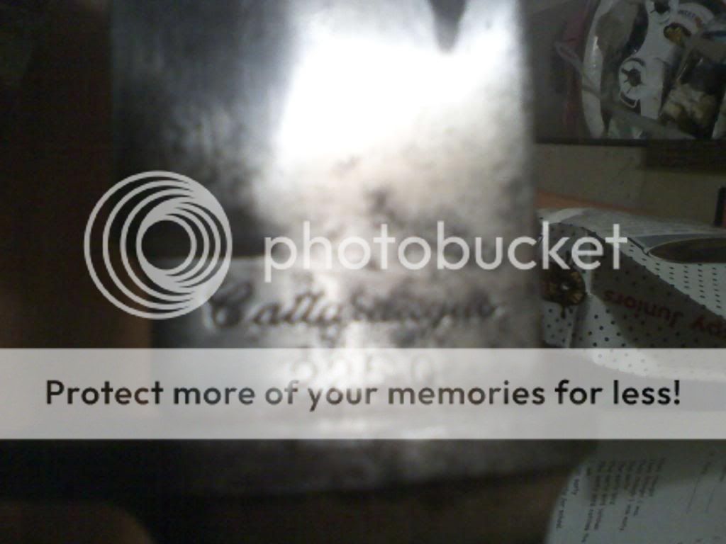

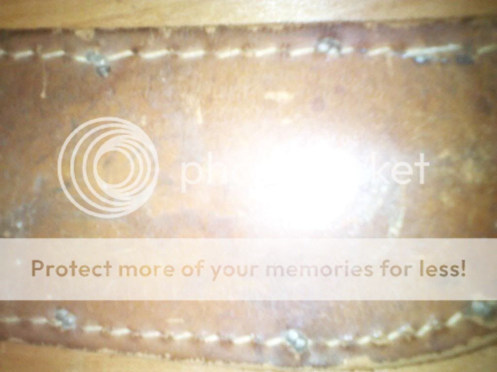

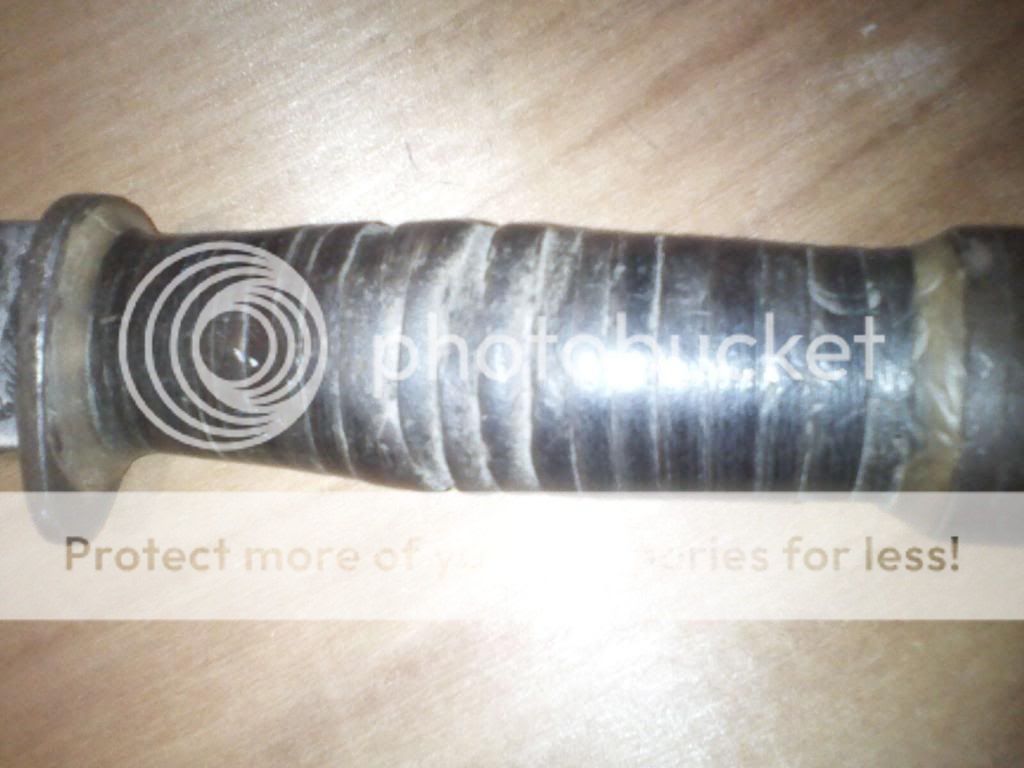

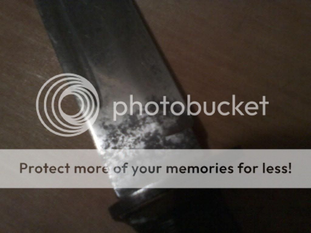

Pics as promised
The last pic shows the last name if you look careful to the left of the glare spot.
I have one I bought from an antique shop here. It's a great user, in my opinion it's easily as tough as any regular production knife (Buck, Kabar, etc.) made today.
For yours, I'd have another sheath made, save the old one, and put this old Cat to good use. My only advice would be to maybe take fine emery cloth to the handle - scuff it just a little, to increase it's "gripiness". The handle on mine was so slick it was almost too hard to keep it properly oriented in my hand while I was using it.
~Chris
I've had the thought that if I end up not liking the handle I would just buy a set of leather washers and form my own to my liking and save the original in case I want to put it back.
