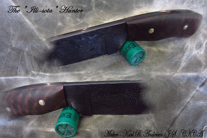

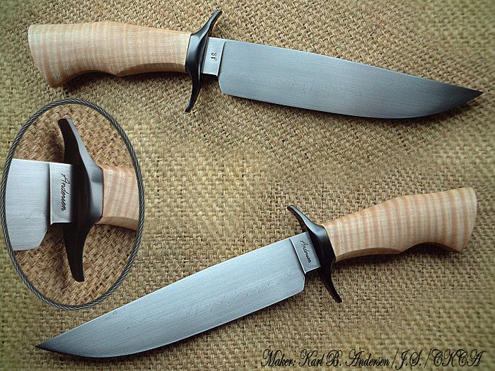

Mr. Andersen, i watched with interest your videos, is the guard in your beautiful w2 ironwood bowie blued by this process? Very very nice!!!
I will setup an outdoor mini bluing rig to start approaching the materials behaviour; by the way, i think i won't need a larger vessel because i'm going to blue only guards/spacers/pommels, one knife at time (long time in beetween sadly, since it is not my job).
In your video on bluing i see you are cooking for half an hour, is it because you where deep etching a damascus blade or that much time is necessary as well just for bluing?

Like Chip said, the info from Brownell's is free.
Get their bluing manual and all your questions will be answered.
The time - 30 minutes - is the required time for the actual bluing process.
Prep time is much longer. Much.
Some of the effects you can get from bluing are very dramatic:

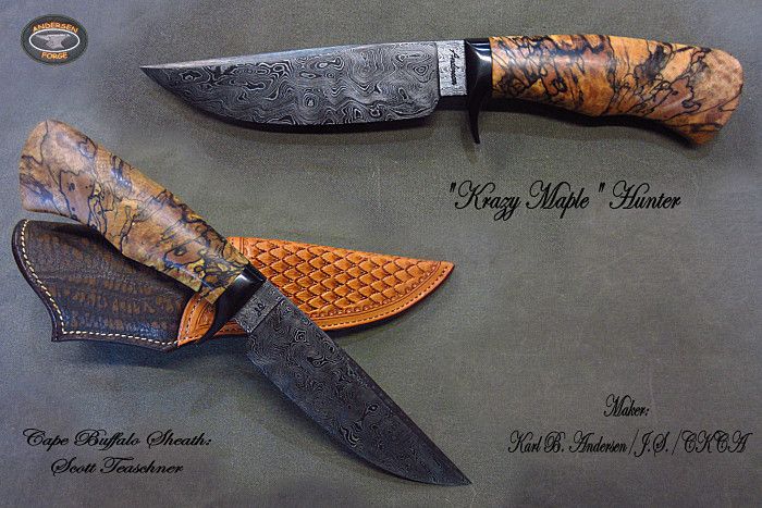

WOW!!
Thanks a lot guys!!
Karl, amazing finish on that stuff!!!!!!
