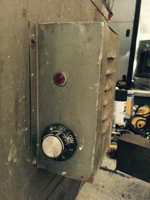

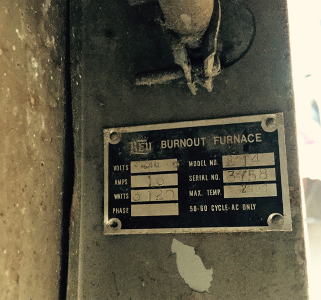

Just picked this up. Free is always good. It's a Rey Burnout Furnace model E14. It's got about a 13"x12"x maybe 10"h interior dimension. I need to swap out plugs this week but everything looks in working order, coils don't look too bad either. Last owner never used it, it supposedly worked when they got it. Only visible flaw I see is the bricks in the door aren't solid as the door seems to flex a bit when opening. Nothing big though. I've read up on pid controls, big question, should I get a cheaper MyPin t4 series from eBay or go with a more expensive Aubins pid?? Heard some have trouble with programming the cheaper ones? The build seems straight forward.

That is a good oven. Those were REAL burnout kilns - 240 volts at 16 amps - and have 3150 watts of power. It will likely do stainless HT with some slight regime modifications. The only drawback is they heat up a bit slow.
Just use the cheap PIDs from eBay if it will be used for carbon steel. If you want to do stainless steel, a programmable PID is needed.
Run a pair of SSRs, or two legs of a three phase SSR ( those are really cheap). Use 40 amp units. Get a new 10 gauge TC and replace the old one. Use a TC block to connect the TC to the PID with type K TC wire. EBay has TC, block, and wire combos that are perfect. Connect the SSR to a 240 volt plug that matches the oven and plug the oven intro it, or just hardwire the oven to the SSRs. The sticky on converting a toaster oven is the same, and there are many threads on the subject. If you aren't sure, PM me.
