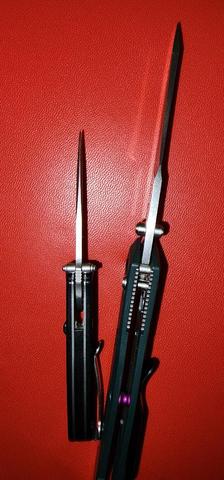

i’m not sure which aftermarket thumbstuds would have compatible threads with ones from benchmade, i’ve only ever used ones from the company itself. any studs that are marketed for benchmades shoult fit, they’re threaded into each other, not the blade itself. the show side is the one that faces inward when you hold the blade in your right hand, blade edge down. the side with the butterfly on it. the back is the side with the blade steel on it
here’s a pic i took a while back with 698 on the left, with a half 950 stud & a half regular stud. the 15080 on the right has a set of adams studs on it

I will have to find out then, I am hoping someone else here knows. You can see how the Gerber sticks out further than the Benchmade one. I need this for pulling up against my pocket with one hand.
