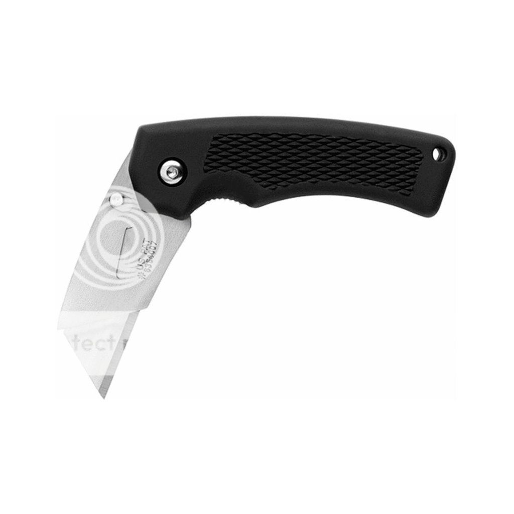

The first Gerber folder has Stanley’s thinest box knife blade at about 0.4mm. (I have to take a diamond grit file to the slots in the blade to get it to fit around the set screw in the knife. Just a touch; not big deal). I resharpen the blades so I don’t have to do this very often. The blade is some how designed different; shorter in length and for a nonretractible handle. I don’t break these in use so a thicker blade is unnecessary.
Obviously the second Gerber has the Carbide edged blade in it for high wear resistance when cutting abrasive junk.

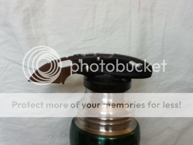

Other blade shapes / serrated / concave-hooked-hawkbill
These three seriously suck for cutting cardboard. Besides being too thick the belly on the blade kicks the edge out of the cut. I was particularly surprised that the littlest one Cold Steel Super Edge did this. I had to literally make three passes when cutting two ply corrugated in one straight slice/cut because the edge kept rising up. Granted I wasn’t sticking it all the way in because I didn’t want to damage the contents of the boxes but basically it boils down to these being uncontrollable night mares for box cutting.
Hooked bill
Cold Steel Super Edge is top in this photo

Wowbagger: I've never seen those Gerber folding utility knife handles before. Thanks for pointing them out. You resharpen your utility knife blades? I never even thought to do that. Might have to try it. I presume the steel is pretty soft? Should be fairly straightforward on my Edge Pro as long as I can figure a way to clamp the blade in place where the stones clear the clamps. Approximately what angle are they usually sharpened at, from the factory? I'd guess a higher angle than the Edge Pro can reach so I'd have to re-profile to a lower angle.
Anyway, part of my objective here is to keep in regular practice with my Edge Pro. But...I really have caught the bug and do want to purchase some knives (but none of the high-dollar antimatter tritanium steels though) ;)
On the carbide blade in your photo, I have carbide grit jigsaw and reciprocating saw blades but it's Hard to tell from the photo...is that blade similar to those with the grit, or does it actually have a long narrow slab of carbide brazed on similar to the way carbides are attached to a tablesaw blade?

If you decide to try the Edge Pro on box knife blades just for fun use the optional magnet for under the blade rest area. That works well for holding the blade. Careful you don’t get cut handling the blade with no handle; very possible as the blade gets stuck pretty firmly by the magnetic pull.
Nah . . . I just sharpen the blade free hand while the blade is in the handle. If you take it out you may as well replace it. Actually the steel is decent. I forget what it is now, these guys probably know, but it will rust (always a good sign).
