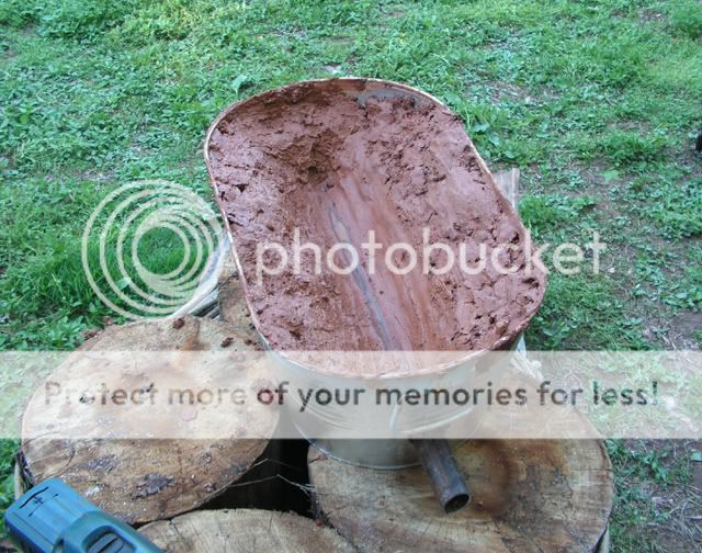

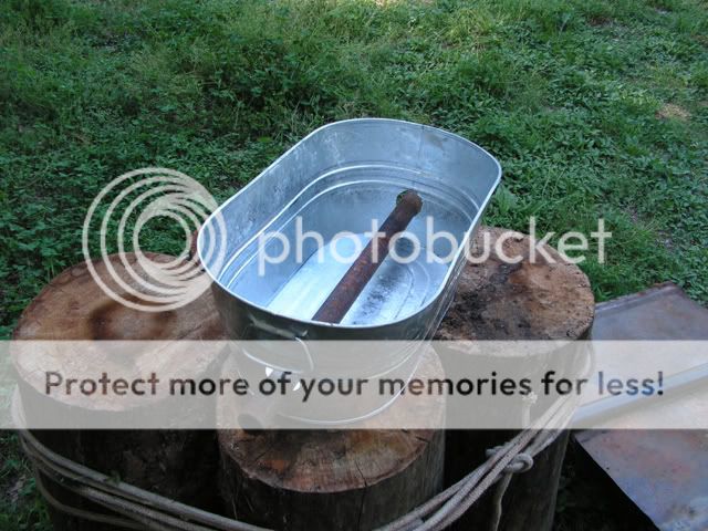

I started with a 5.5 gallon oval washtub. (this one was used as a planter at a wedding) , a 30″ long piece of 1″ black iron pipe, good old ‘Carolina clay, an old vacuum cleaner hose, a tupperware container and a 14″ hand cranked blower.
I drilled 1.5″ holes in the ends of the tub for the pipe ( called a Tweer in a forge) and a bucket of clay. Tim used adobe , I have clay.
All I’m doing is building a U shaped trough down to the tweer which will insulate the sides. I’m shooting for about 2″ of fuel under the iron and the same above. Get your hands dirty, will not hurt bad. And then I let it dry overnight.

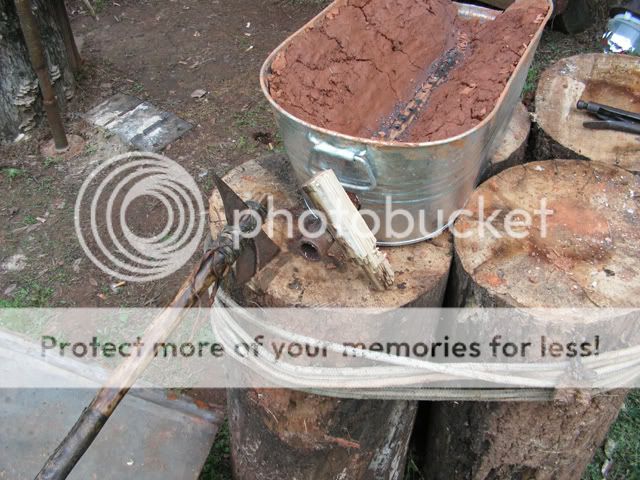

Next I drill a series of 1/4″ holes in the tweer about an inch or so apart(air outlets) and I needed to adapt my 3 1/2″ outlet on the blower to the 1 1/4″ hose. I went through Lovely Brides Tupperware and found one that fit the outlet and cut a hole in the bottom for the hose. A piece of HVAC tape seals it.
I need to plug the other end of the tweer pipe. If you buy pipe get one end threaded and use a cap. I had this pipe laying around and it’s not threaded so a chunk of wood out of the burn pile will do for now. We need this end removable to clean out the ash on occasion.

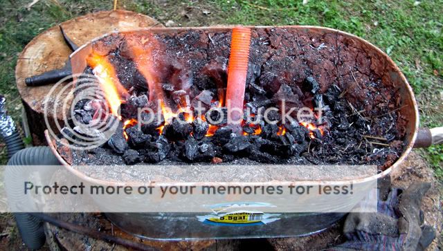

Lets crank this thing up. The clay is still damp and it will crack as it drys, after the first fire I’ll put a thin coat on it to fill cracks. The clay works good, after several fires it turns very hard and reflects heat well. Think of a fired pottery finish.

And throw a little iron in it. That is a railroad bolt, 1 1/4″ thick.''
That’s after about 5-6 minutes. It will get hotter as it cures and will be easier to bring up to heat.
