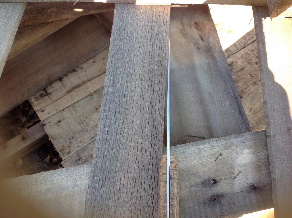

Tapering the tip so it's nice and thin is what worries me the most. The stock is 0.10" so not that thick but only 1.5" wide which compounds the problem of being too thick.
On my first knife I had a hard plunge at the front of the scales, photo here and here. This time I will be going for no plunge.
That looks good. Are you doing another gyuto? Grinding at an angle, like in the video, it will give it some distal taper. This is one I did and I didn't distal taper it to start. It's 2 inches tall and has more drop at the tip than a gyuto so it tapers more. Give it a shot and let us see your progress.

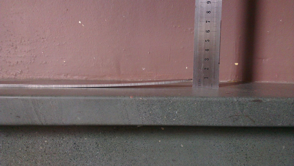

Alright I gave it a practice go on a bit of scrap to get a feel for it, I found either grinding the taper before beveling or grinding the spine as don nguyen suggested worked well for me.
Problem I'm having now is the blade is warping like crazy as I grind the bevels and I can't work out why. I'm going fairly slow with little pressure, the blade is getting warm at most but after grinding maybe 75% of the initial bevel there is a cm of deflection. :confused:
I've had this type of warping as well on thinner stock knives. The good news is that you can fix it fairly easily. The steel believe it or not does have certain tensions in it, even after tempering. When you grind one side of the blade, the other side becomes far thicker in relation, and this sets up the tensions that pulls the blade. To prevent this you should grind both sides as you go. Not at once mind you, but a bit of one side and then switch. Make sure you scribe your center lines before grinding so you have those references (spine, edge and heal). Once you have both side ground to the same thickness, the blade should be straight again. But yes, it is a pain.
Warping like that is common on steel that has stress in it or steel that's been cold rolled. See that a lot in the machining world. Is that "scrap" you practised on actual blade steel or just mild steel. Any time I see this start to happen with blade steel I normalize/stress releave it in the forge or oven. What's happening is the steel has stress on both sides and if you remove steel from one side your also removing the stress from that side and the blade is pulled twords the side with more stress. This can be corrected by grinding the other side but it's usually more hassle and does not alow for a good perfect grind. This is why I highly recommend stress releaving your blade steels if this shows up. This is can also show up in forged blades which is one reason after forging you normalize and release the stress. Some times the stress does not show up till you hear it for the heat treat. Then it relaxes and goes where it wants. So good rule of thum is let it go where it wants befor you start working in and you will be much happier.

Are you using AEB-L? It often warps like an SOB, whether heat treated or not. Using sharp belts helps, alternating a few passes each side, keeping it cool as well. Sometimes not a lot can be done to fix them if they warp, I have had success with shimmed tempers when necessary, but often they will take more work and overcorrection than say a 52100 blade will.
They say that it is because AEB-L comes off of a roll, so has a tendency to return to a curved shape. Could be, but I have seen that it will often curve whatever direction the grinder promotes. Many times the side being ground will become the top of a bow in the stock, which can be exasperating to the learner, as the wish to then remove that high point will lead to yet more bowing!
I have a theory about what may sometimes be the mechanism- if using anything but a nice sharp belt, part of what the abrasive grits are doing is peening rather than cutting, which increases surface area slightly at the grind. This the causes the steel to bow away from that point, much like the Berardo hammer-straightening technique. I think AEB-L is particularly susceptible to this. It seems to occur more markedly in hardened blades. Speaking of said Berardo technique, I've tried it on AEB-L but it doesn't work for me- I quench that steel and follow with dryo (dry-ice, not true cryo) then temper pretty lightly, so 62 rc. All I can say is you'd better have a pretty well hardened straightening hammer face to make a dent (literally) in that stuff. I suppose you could make a super-hard straightening hammer.
But then, sometimes it will bow the other direction, pulling toward the grinder. Especially on the surface grinder, it wants nothing more than for the ends to cup up toward the stone. I'll admit sometimes I still chase the stuff in circles!
Plate quenching after profiling, before bevel grinding, and keeping it cool are the best prevention, and that's the best cure- chasing warp out of AEB-L sucks.
Yes! Although I'd call it burnishing rather than peening, although perhaps both happen to a certain extent. I think this is exactly the problem I've personally had with a few thinner blades. You can see it begin to happen, when your belt is becoming dull, and the finish it leaves goes from a nice satin with imperceptible scratch marks (at whatever grit) to a shiny white with grit size scratches. If I get that shine when doing finishing grinds, that now signals me to A) change belts or B) redress the belt to expose new edges (in context of finish grinding I really only do this with trizacts)
ETA: Thinking about it now, and the rest of your post, I think now maybe the "peening" pushes it away and the "burnishing" pulls it into the grinder. One creating higher surface area, one reducing surface area.
