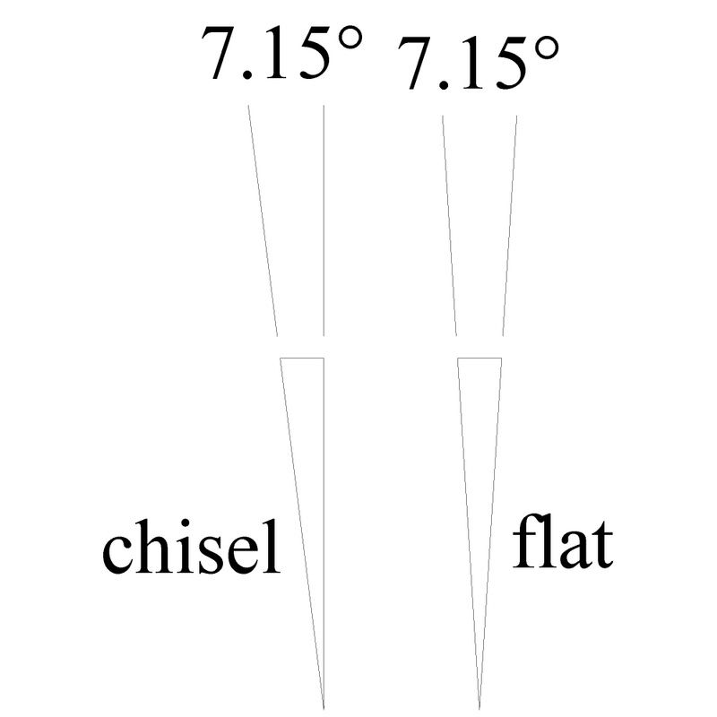

ok...i know everyone says chisel grinds are sharper etc. but how does this work? i'm talking about flatgrinds, not hollow or convex (which flatgrinds are usually what i see anyways) if you have a 1/8" knife and a 1" wide bevel, it doesnt matter if you do a chisel grind or normal flat grind, you still get a total angle of about 17.5 degrees, sooo...whats the point? is there something i'm missing?:confused:

that's what i used to think too, but then i thought about it awhile and it didnt make sense, so i drew it up in autocad a bevel on 1/8" stock 1" up
that shows that a chisel grind isnt thinner than a flat grind, unless the chisel grind is twice as long as the flat grind or the stock is half as thick, which you could simply extend the flat grind or thin the stock for it, thus negating any benefit

actually, the whole point of that picture is that a chisel grind has the exact same amount of steel behind the edge, if anything it'd be weaker since it is only supporded on one side when youre cutting

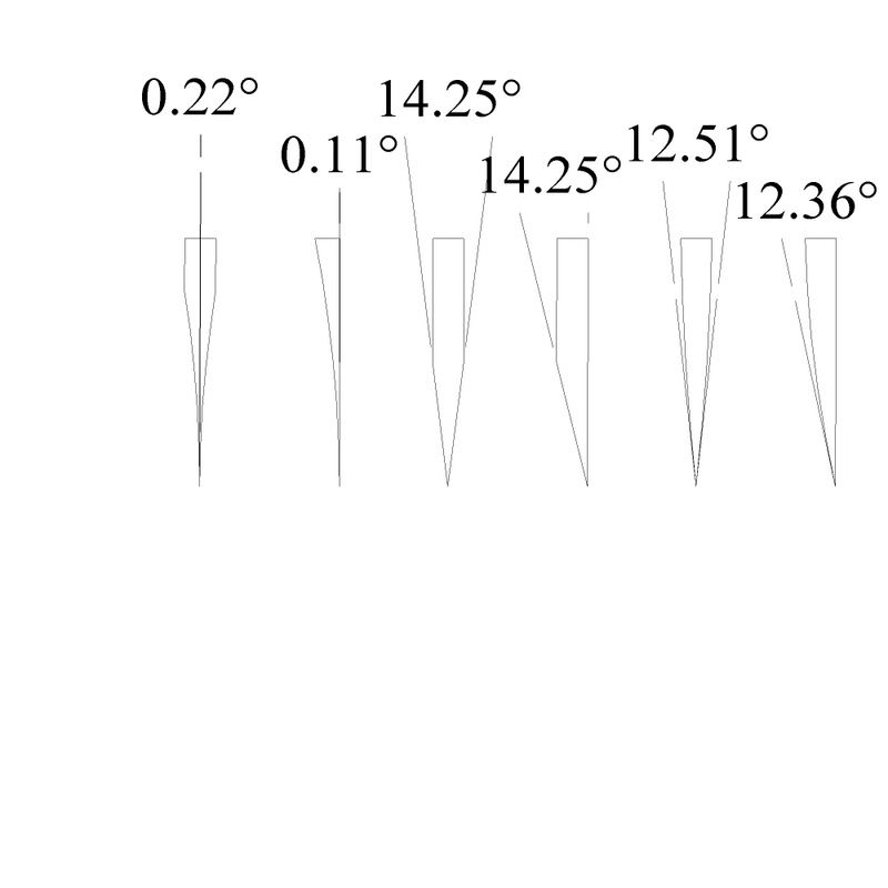

Hey, mrstenoien, would you mind running those autocad programs again, except this time place the chisel grind and 'v' grinds halfway down the 1/8" steel instead of all the way to the top? I'm not sure if this changes this observation or not, and I lack the mechanical aptitude to prove my own theory wrong. Thanks if you can pull it off!
...btw, one of these days you've got to explain your screen name to me.:confused: :)
Id love to see one with a hollow on one side and a chisel on the other in addition if your going to autocad anymore :D If not that's cool, thanks for the first diagram.
here they are
and now you can see why I didnt include hollow grinds in my question, not sure why the convex ground were a little different but i dont think youre going to see a difference if your blade is .15 degrees more acute :D but the way I measured the convex and hollow ground is I measured the angles of the tangent line .01" up on the bevel, obviously youre not going to zero grind a hollow ground knife but this data still applies. the "wheel" the hollows were ground on has a 10" diameter. also, my sn is simply Mr Stenoien, Stenoien is my last name, and I use mrstenoien for everything b/c it's one sn that is never taken!
