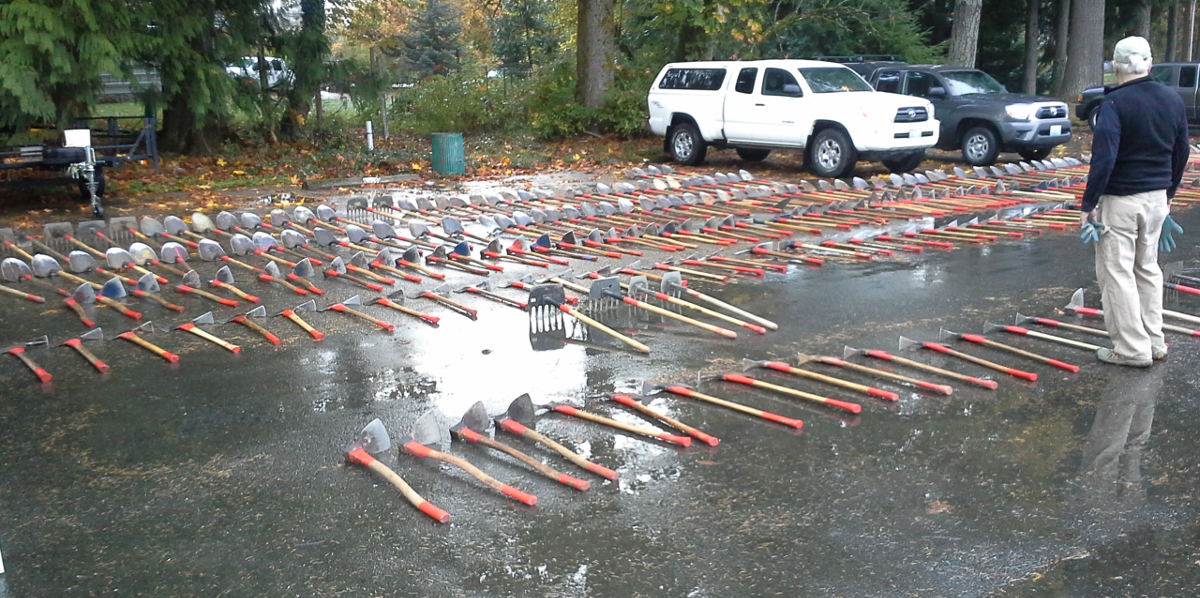

Here's those work stations. Mine is up front and you can see part of another I put together on the far right. These old steel Workmates are pretty handy. Even older ones has cast aluminum frames. I've since upgraded to one of those.
Very handy when you have a lot of tools to clean and sharpen.
Holy crap that is sweet ! ^ I can see how you would get tired of that. I remember you sayin about the Pulaski's once.
