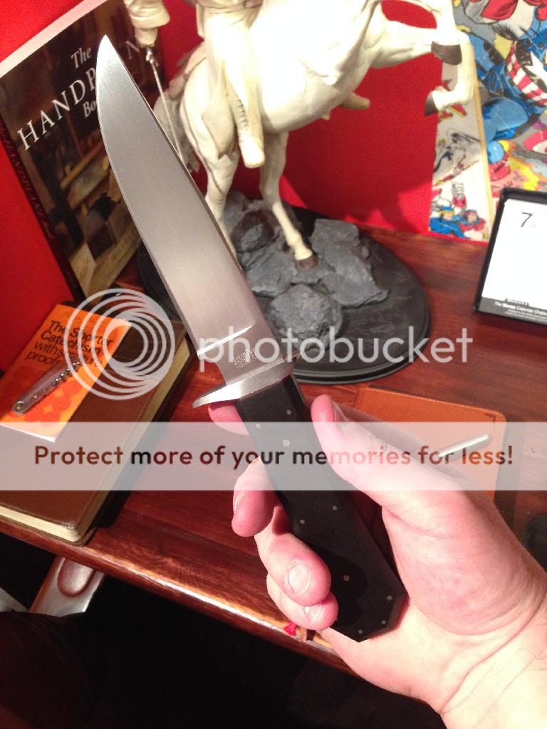

this is the coffin handle one i have, it's about the right size for a bushcraft knife:
Thats a beautiful understated elegant knife. Less is more. Good, that you got it in the end....well, not like that....., you know what I mean:D
